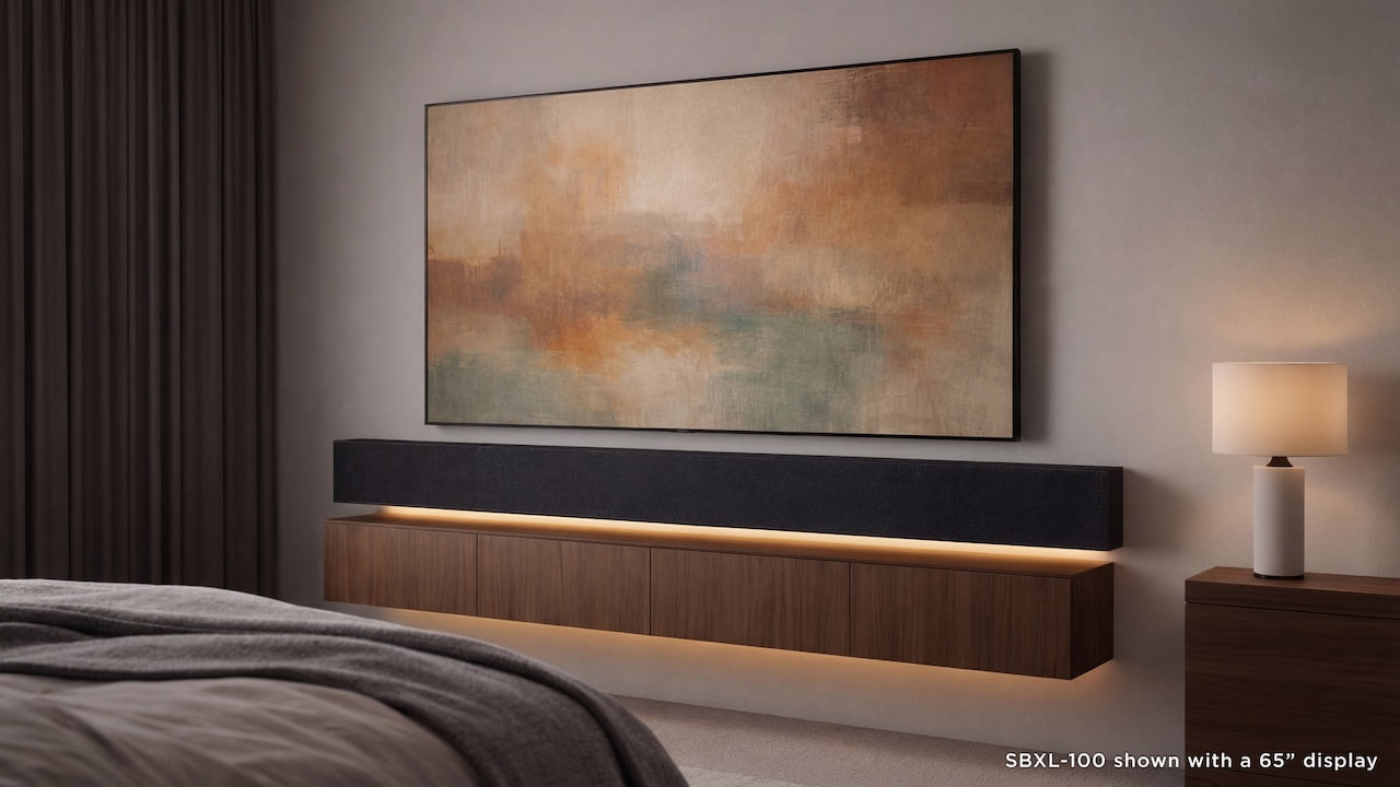

Sonance SBXL-100 Soundbar Lifestyle with 65-inch TV

The SBXL-100 is an enormous 82.68-inch-wide powered soundbar designed specifically to look proportional beneath large-format televisions. The PowerPipe X Series takes the opposite visual approach, hiding the subwoofer enclosure inside a wall, ceiling or cabinet and allowing only its bass port to enter the room.
One wants to look like it belongs beneath a giant television. The other would prefer that you never see it at all.

At nearly seven feet wide, the Sonance SBXL-100 is not competing with the average $700 Dolby Atmos soundbar.
sonance-sbxl-100-soundbar
The 2.0-channel design measures 82.68 x 8.11 x 4.05 inches and uses a 6.5-inch anodized aluminum woofer, 1.2-inch cloth-dome tweeter and integrated passive radiators. Sonance specifies a 38Hz to 25kHz ±3dB frequency response, 87dB sensitivity and 4-ohm nominal impedance.
The package includes Sonance’s UA 2-125 ARC amplifier, providing 250 watts RMS of total system output. HDMI ARC/eARC and CEC allow the television to handle audio and volume control through a single HDMI connection.
Sonance says the SBXL-100 can operate without a separate subwoofer. A claimed 38Hz lower limit makes that plausible for television, music and many media rooms, although anyone building a dedicated theater will probably still want considerably more happening below 40Hz.
Physics has not been removed from the installation manual.
