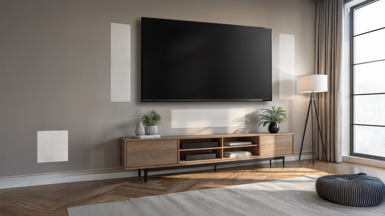

Monitor Audio Creator Series In-Wall Speakers and Subwoofer
Hiding loudspeakers has become relatively easy. Hiding serious bass is another matter.
Architectural speakers can disappear behind paintable grilles without turning a room into an equipment showroom, but subwoofers still need large drivers, sufficient enclosure volume, plenty of power, and somewhere for all that energy to go. That usually means surrendering floor space to a large box or planning the bass system before anyone starts hanging drywall.
Monitor Audio expanded its Creator Series at CEDIA 2026 with three new in-wall subwoofer systems designed to address that problem. The WS1-W10, WS2-W12, and WS3-W12 use 10- or 12-inch low-profile drivers, purpose-built enclosure solutions, and dedicated DSP amplification, extending the same Tier 1, Tier 2, and Tier 3 structure already used throughout the company’s Creator architectural speaker lineup.
The systems start at $2,450 and climb to $6,150 for the flagship WS3-W12. None of them qualifies as inexpensive bass, but nobody shops for a high-performance subwoofer that gets buried inside the wall because they were looking for the easy route.

Why Is the Creator Approach Different?
monitor-audio-in-wall-subwoofer-cutaway
In-wall subwoofers are not new, and Monitor Audio is hardly the first manufacturer to discover that home theater owners would rather feel a subwoofer than stare at one.
What makes the new Creator range interesting is how closely the bass systems follow the structure of the rest of the Creator ecosystem. Instead of introducing one architectural subwoofer and expecting it to cover every room and budget, Monitor Audio offers three clearly defined performance levels with amplification and installation hardware engineered around each application.
That simplifies system specification. An installer building around Tier 1 Creator speakers has an obvious corresponding bass solution, while more ambitious Tier 2 and Tier 3 theaters can move up in output and enclosure sophistication without switching to an unrelated product family.
The WS1-W10 is particularly clever because it preserves retrofit flexibility while the two 12-inch models prioritize predictable acoustic performance from purpose-designed enclosures. Monitor Audio has essentially separated the range by how the room will be built as much as by how loud the customer wants it to play.
There is one unavoidable caveat. Once an architectural subwoofer is installed, moving it three feet to deal with a nasty room mode is no longer an afternoon project. Careful placement, calibration, and in many rooms multiple subwoofers remain important regardless of how sophisticated the hardware becomes.
