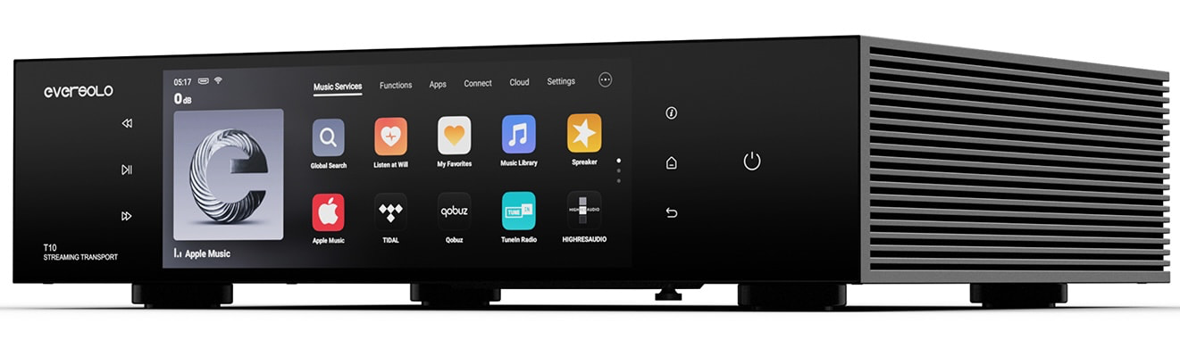

Eversolo is using HIGH END Vienna 2026 to launch the T10 Streaming Transport, a dedicated digital source component designed for systems where the DAC, amplifier, and loudspeakers are already sorted, but the streaming front end still needs to be cleaned up. The T10 will debut at Booth 1.14, Level 1, during the show from June 4–7, 2026. Pricing has not been announced, and Eversolo only says availability is expected “in the near future.”
The T10 is not an all-in-one streamer, DAC, preamp, or integrated amplifier. It is a streaming transport, which means its job is to receive, organize, and output digital audio as cleanly and consistently as possible to an external DAC. That distinction matters. This is for listeners who already have a DAC they trust and want a more advanced digital source feeding it.

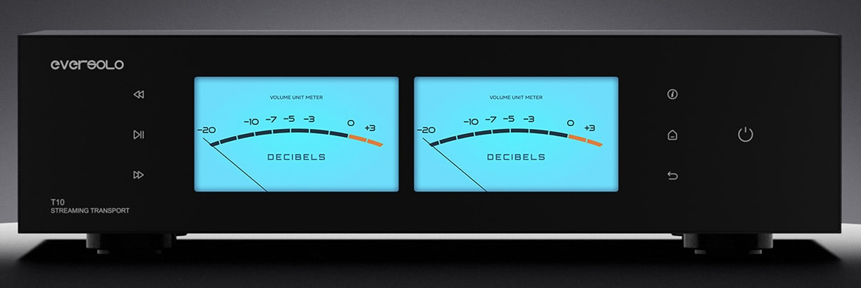

The chassis measures 365 mm x 310 mm x 88 mm, or roughly 14.4 x 12.2 x 3.5 inches, and includes an 8.6-inch LCD touchscreen. The front display handles browsing, playback information, VU meters, spectrum views, and ambient visual modes. Some people will love the animated campfire and forest scenes. Others will wonder why their streaming transport suddenly looks like it’s about to crown a May Queen and make a very questionable decision in a barn. Either way, the display is not an afterthought; it is a major part of the T10’s identity.
Inside, Eversolo has focused heavily on power supply design, electrical isolation, and clocking. The T10 uses a custom O-Type linear power supply with a toroidal transformer and a claimed noise floor below 35µV. The company also says the chassis uses internal physical partitioning, interface isolation, and shielding around the display to reduce interference between the digital, power, and control sections.

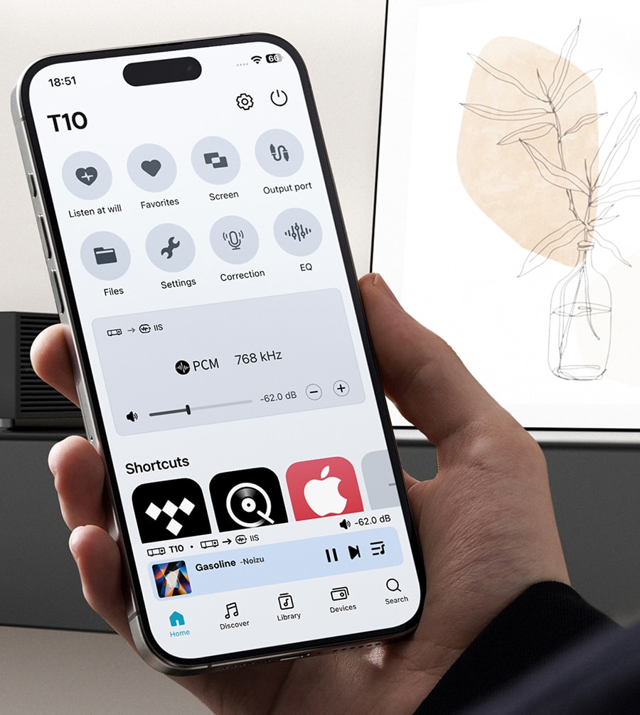

The software platform supports major music services including TIDAL, Qobuz, Amazon Music, Deezer, Apple Music, HIGHRESAUDIO, IDAGIO, SoundCloud, Presto Music, TuneIn, Radio Paradise, Calm Radio, and internet radio services. It also supports Spotify Connect Lossless, TIDAL Connect, Qobuz Connect, DLNA, and additional streaming protocols.
Eversolo also claims the T10 can scan about 200,000 tracks in roughly two hours, with support for cross-platform playlists, global search, and full-library shuffle playback. That matters if your local library has grown from “a few albums” into “someone should probably intervene.”
eversolo-t10-streaming-transport-app
Control options include the touchscreen, Eversolo’s Android, iPhone, iPad, and TV apps, remote control, and trigger out. The T10 also includes evotune room correction, which can generate acoustic compensation profiles for different listening spaces. That is unusual for a streaming transport and potentially useful, although final judgment depends on how well the software measures, filters, and integrates with real rooms.
