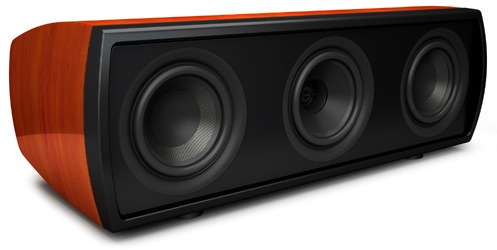

Aperion Audio Verus Forte Center Speaker

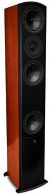

Aperion Audio Verus Forte Floor Standing Speaker
Key Features of the Aperion Verus Forte Tower
  • 3-way, ported, curved cabinet design
  • 1-inch Aperion Axially Stabilized Radiator silk dome tweeter
  • One 4.25-inch woven Kevlar mid-range driver with aluminum phase plugs
  • Two 4.25-inch woven Kevlar woofers with butyl rubber surrounds
  • Bi-ampable 5-way gold-plated binding posts
  • Furniture-grade gloss real cherry-wood veneer or gloss piano black finish
  • Anti-resonant MDF cabinet with internal bracing
  • Acoustically transparent cloth-covered metal grille
Specifications of the Aperion Verus Forte Tower
  • Frequency response: (+/- 3 dB) 53-20,000 Hz; (+/- 6 dB) 47-22,000 Hz
  • Nominal impedance: 6 ohms
  • Sensitivity: 90 dB
  • Recommended power: 20-300 watts
  • Driver configuration: 3-way
  • Bass alignment: ported
  • Dimensions: 35 inches high by 6 inches wide by 8.25 inches deep
  • Weight: 30 pounds
