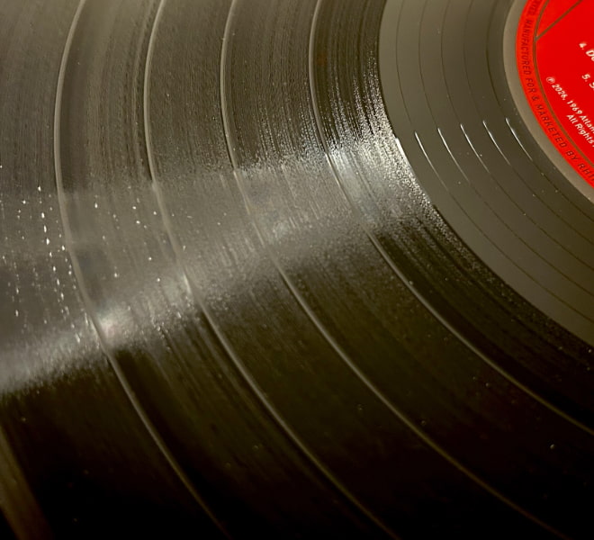

Unfortunately, on Side 2, I began to hear nasty noises, which turned out to be a rather significant rash of “non-fill.” This production error can happen when the vinyl does not melt well enough to flow into the metal stamper grooves. An imperfect copy results, bearing tiny audible pits where the vinyl didn’t fill the grooves (thus the “non-fill” designation). You can usually easily see these telltale markings, such as in the photo following.

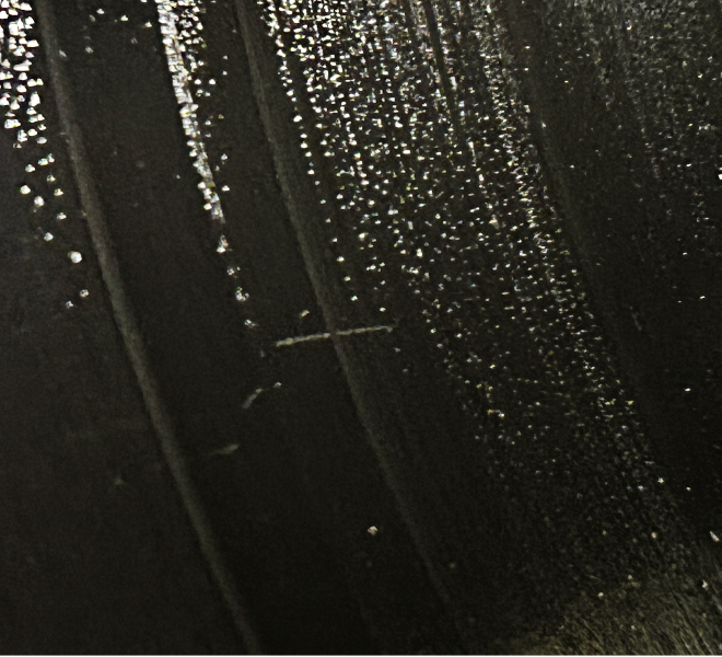

Unfortunately, my second copy also had non-fill issues, and this time there was also an audible hairline scratch on one side! This is a very unusual occurrence, in my experience, for records pressed at Optimal. I am not entirely surprised, given the strange, upside-down socioeconomic times our world is enduring these days, where understaffing and overwork are the norm. Someone clearly was rushing the process to meet deadlines.
Cher Jackson Hwy. RhinoHiFi scratch example 660×600
