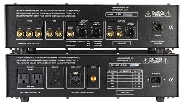

LAMM Industries LL1 Signature Preamplifier - Rear
