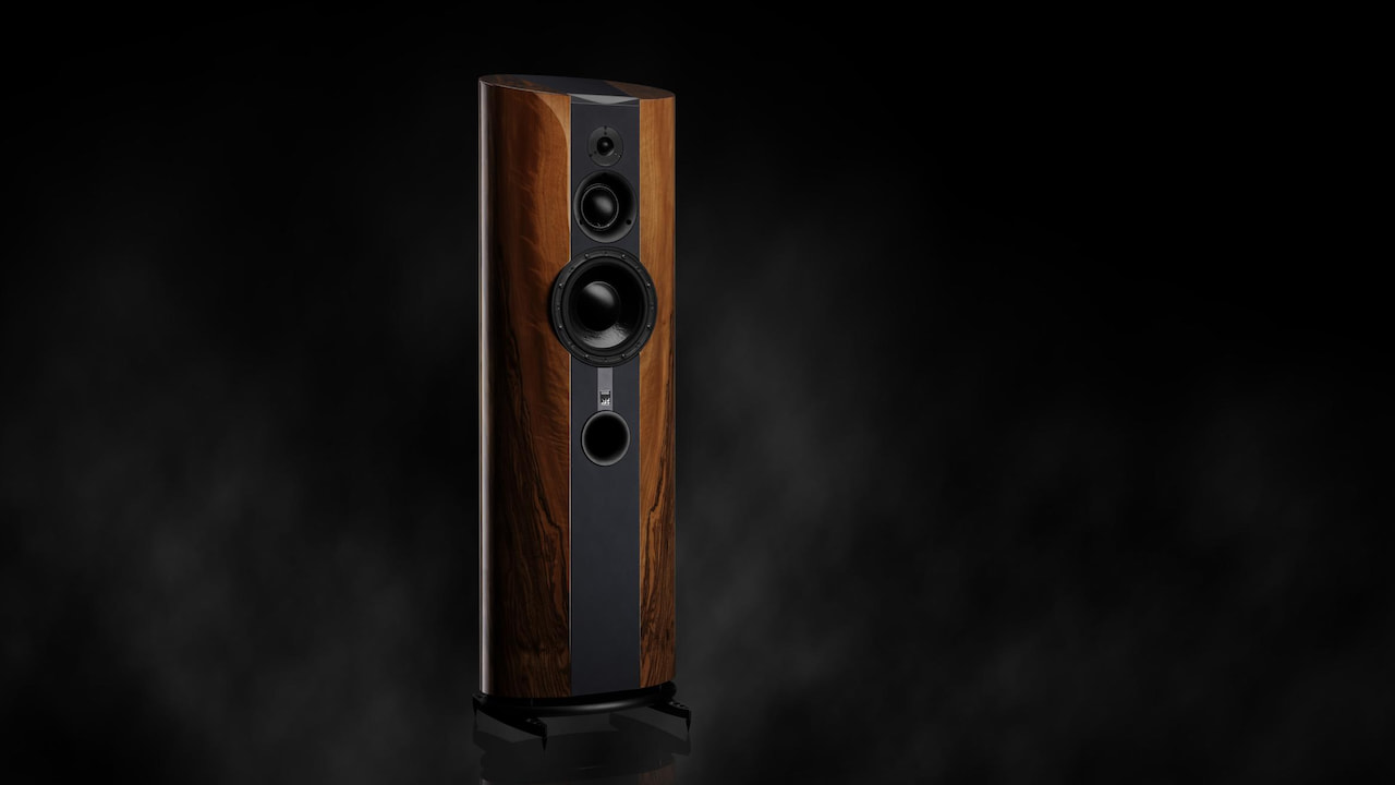

ATC doesn’t do anniversaries for the sake of nostalgia. The launch of the EL50 Anniversary is a reminder of why the UK manufacturer has spent decades earning its reputation the hard way, building loudspeakers that dominate professional studios and quietly embarrass a lot of luxury home audio. Rooted in the original “50” design introduced in 1978, the EL50 Anniversary is a limited-production, fully active 3-way tower that distills nearly half a century of engineering, refinement, and real-world credibility into a single statement product.
Priced at £49,500 ($99,999 USD per pair), the EL50 Anniversary firmly positions itself in statement territory. That credibility, however, is not theoretical. ATC has collected dozens of industry awards over the years, including Editors’ Choice honors for studio-grade standouts like the SCM50ASLSCM20ASL, and SCM40A—models that have become benchmarks for accuracy, control, and long-term listenability. The EL50 Anniversary builds directly on that lineage, combining ATC’s in-house drive units with its discrete active tri-amplification architecture, a technology lineage that stretches back to the SCM70 of the 1990s and has been refined ever since.

Building a £49,500 loudspeaker means the cabinet cannot be an afterthought. With the EL50 Anniversary, ATC has revised and upgraded its enclosure construction using advanced in house manufacturing techniques aimed at increasing stiffness and improving internal damping. The goal is straightforward: reduce cabinet borne coloration, particularly through the upper bass and midrange where structural energy can blur detail and alter tonal balance.
The bass driver is mounted within a precision turned aluminium ring that bolts directly into the cabinet face, increasing mechanical integrity and creating a more rigid coupling between driver and enclosure. The curved front baffle and softened cabinet edges are not cosmetic flourishes. They are designed to smooth the transition of driver output into the room, reduce edge diffraction, and maintain a more uniform on and off axis frequency response. In practical terms, that means improved linearity and fewer audible artifacts caused by the box itself.
Visually, ATC has taken a more expressive approach than in the past. Hand selected and carefully matched European walnut veneers wrap the curved cabinet elements, complemented by ebony inlays on the rear panel and finished in a high gloss polyester lacquer. Upholstered napa leather panels surrounding the midrange and tweeter, along with the lower front section, introduce texture and contrast.
Yes, the use of leather will raise eyebrows in Italy. Sonus faber practically turned leather baffles into a national design language decades ago. But at this level, expectations are high. Buyers are not just paying for measured accuracy; they expect a finish that feels deliberate and distinctive. In that respect, this may be the most visually compelling loudspeaker ATC has ever produced. The engineering remains unapologetically functional, but for once, the aesthetics are stepping confidently into the spotlight alongside it.
