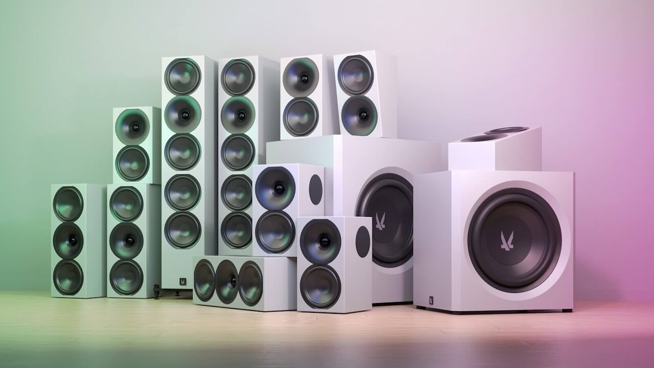

Arendal 1961
The 1961 Series includes 8 models
The 1961 Series uses trickle-down technology from Arendal’s step-up 1723 series, including waveguide tweeters and custom drivers that support precise, dynamic sound reproduction. The 1961 series incorporates HDF cabinets and hand-painted matte Black and White finishes. This shared signature sound and look means 1961 models can be easily mixed and matched with other Arendal speaker set-ups as needed.

The 1S and 1V are Arendal’s 1961 Series Subwoofers. They are designed to deliver more than you might expect in their price range. Both subs incorporate an Arendal proprietary 12.2-inch driver driven by their custom 550W RMS Avalanche 550 IQ DSP amp.
For added support, the cabinet volume of both subwoofers has been increased to produce an optimally damped system with low distortion while delivering dynamic and natural deep bass.
The 1S is positioned as an Arendal “entry-level” subwoofer model in the 1961 series, while the 1V is the step-up model. The main differences are that the 1S has a smaller cabinet profile with a sealed design, whereas the 1V is larger and provides a port (vent) that provides additional low-frequency output support.
Arendal 1961 Avalanche Subwoofer Front and Back White
