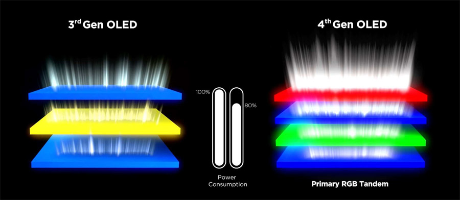

RGB Tandem OLED
OLED MLA-based META proved to be effective at raising OLED brightness, but apparently not effective enough for LG Display’s goals for OLED TV applications. After only two years in use, LG Display abandoned its 3rd Generation OLED META Platform in 2025 for a 4th Generation platform. Instead of using MLA as a core component, LG Display developed what it refers to as Primary RGB Tandem Technology.
OLED TV Panel Technology Generations
This panel structure is also referred to as “four-stack” as it consists of two OLED layers of blue elements, while the yellow OLED element is divided into component green and red elements.
OLED RGB Tandem Technology Illustration
The result of this panel technology is that better color accuracy and increased light output (brightness) can be achieved without requiring the MLA layer, thus reducing complexity. LG Display claims that the Primary RGB Tandem panel can provide as much as 4,000 Nits peak white brightness (2,100 nits color brightness) which rivals the brightest LED/LCD-based TVs and also puts it on par with Samsung’s most recent QD-OLED panel implementation.
LG Display has also indicated that the color gamut for DCI-P3 coverage has been boosted from 98.5% with previous MLA OLED panels to 99.5% with the 4-stack panel.
