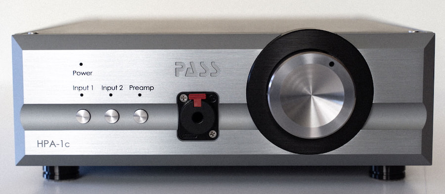

Pass Labs didn’t simply resurrect the HPA-1 and give it a new badge. The original HPA-1 was eCoustics Headphone Editor W. Jennings’ longtime reference, a class A workhorse that earned its place on the rack, and the new HPA-1c builds directly on that legacy. The core amplifier design stays the same because it didn’t need reinventing, but the move to replace aging components opened the door for meaningful improvements.
The updated power supply and better circuit board grounding give the HPA-1c a more stable electrical foundation, lowering noise and tightening regulation for a noticeably darker background. Pass Labs also added local regulation to the servo circuit and achieved about a 10 dB drop in the overall noise floor.
That translates to more low-level detail and improved clarity, especially with sensitive headphones that expose everything. And just like the original, the HPA-1c remains a full-function line-level preamp with enough drive and composure to sit confidently at the center of a reference loudspeaker setup.
pass-labs-hpa-1c-headphone-amp-silver-front
The HPA-1c isn’t picky about what you plug into it. It works comfortably with headphones from 15 ohms all the way up to 600, and it was designed as a power amplifier first, not a conventional headphone amp, which is why it handles low impedance planar designs with real authority. The low feedback wide bandwidth circuit is fully discrete, and the class A direct coupled MOSFET output stage keeps the signal path honest.
A custom low noise toroidal transformer with a Faraday shield anchors the power supply, and the audio circuits benefit from discrete regulation that keeps the performance stable and the noise floor buried. This is very much a Pass Labs take on a modern reference headphone amplifier, and the engineering reads exactly like that.

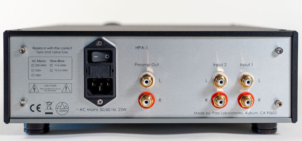

Connectivity remains intentionally simple: two single-ended line inputs and one quarter-inch headphone output. There are no balanced headphone outputs or balanced input options, which fits the HPA-1c’s design philosophy of keeping the signal path short, direct, and discrete.
