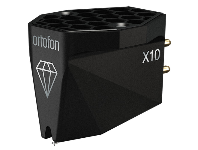

The MC X10 uses a refined elliptical stylus. It’s the simplest shape—rounded like a ballpoint pen. Easy to align, forgiving, but not the last word in resolution.
ortofon-mc-x10
Ortofon MC X10 Cartridge Specifications
  • Output Voltage: 0.4 mV @ 1kHz, 5cm/sec
  • Channel Balance: 0.5 dB @ 1kHz
  • Channel Separation: 24 dB @ 1kHz
  • Frequency Response: 20 Hz – 20 kHz, ±2 dB
  • Tracking Force (Recommended): 2.0 grams
  • Compliance (Dynamic, Lateral): 13 μm/mN
  • Stylus Type: Elliptical
  • Stylus Tip Radius: r/R 8/18 μm
  • Cantilever Material: Aluminium
  • Stylus Suspension: Ortofon exclusive
  • Coil System: Quad coil design
  • Coil Wire Material: High-purity silver
  • Internal Impedance (DC Resistance): 6 Ω
  • Recommended Load Resistance: > 50 Ω
  • Cartridge Weight: 8.6 grams
