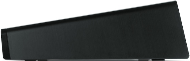

Olive O6HD Audiophile Music Server - Black - Side
More than just a shell, the O6HD's elegant aluminum enclosure eliminates operational noise and resonances. A distinctive angled front includes a huge 10.1″ glass-on-glass color touch-screen, both of which allow for easy navigation of the music library. The music library has capacity for up to 6,000 CDs in original quality or up to 20,000 High Definition tracks on the O6HD's internal 2TB hard disk drive, which is cushioned in 8 layers of noise-canceling padding.
Even the 06HD's Anti-Vibration Feet play a role in producing sound that is pure, with each foot designed in a 2-part, special polymer mold. This allows the chassis to float above its supporting surface and protect it from outside vibrations and resonances, which can negatively affect sound performance. Furthermore, Olive has chosen a unique fan-less cooling system further eliminates operating noise.
