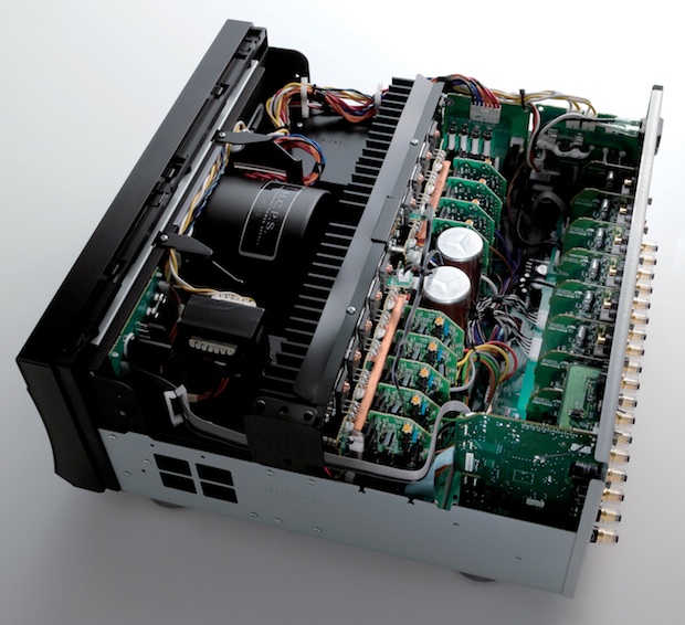

The DTA-70.1 is an all-analog discrete-component power amplifier with a massive power supply and professional-style balance line inputs. Each channel has identical symmetric circuit layouts, configured in a push-pull topology utilizing high-performance three-stage inverted Darlington circuitry and powerful custom-designed output transistors. Like all Integra amplifiers and receivers, it uses the company’s WRAT (wide range amplifier technology) with low negative feedback, closed ground-loop circuits, and HICC (high instantaneous-current capability) to achieve an extended frequency range, low noise, and high dynamics.
The large, 11.7-Amp power supply of the DTA-70.1 uses a massive toroidal power transformer with dual 22,000 µF capacitors. This gives the system excellent short-term transient power impact, with an FTC Dynamic Power specification of 180 Watts into 8 ohms, and 400 Watts into 3 ohms. The power bandwidth is 5 Hz to 100 kHz, +/-3dB, and the IHF A-weighted signal to noise ratio is an excellent 110 dB.
The amplifier’s chassis has a thick, solid aluminum front panel and employs heavy-duty construction throughout for maximum rigidity and resistance to resonances. All the circuit boards employ thick 70µm copper foil for high current capability and low impedance, and the use of heavy copper bus plates eliminates grounding issues.
