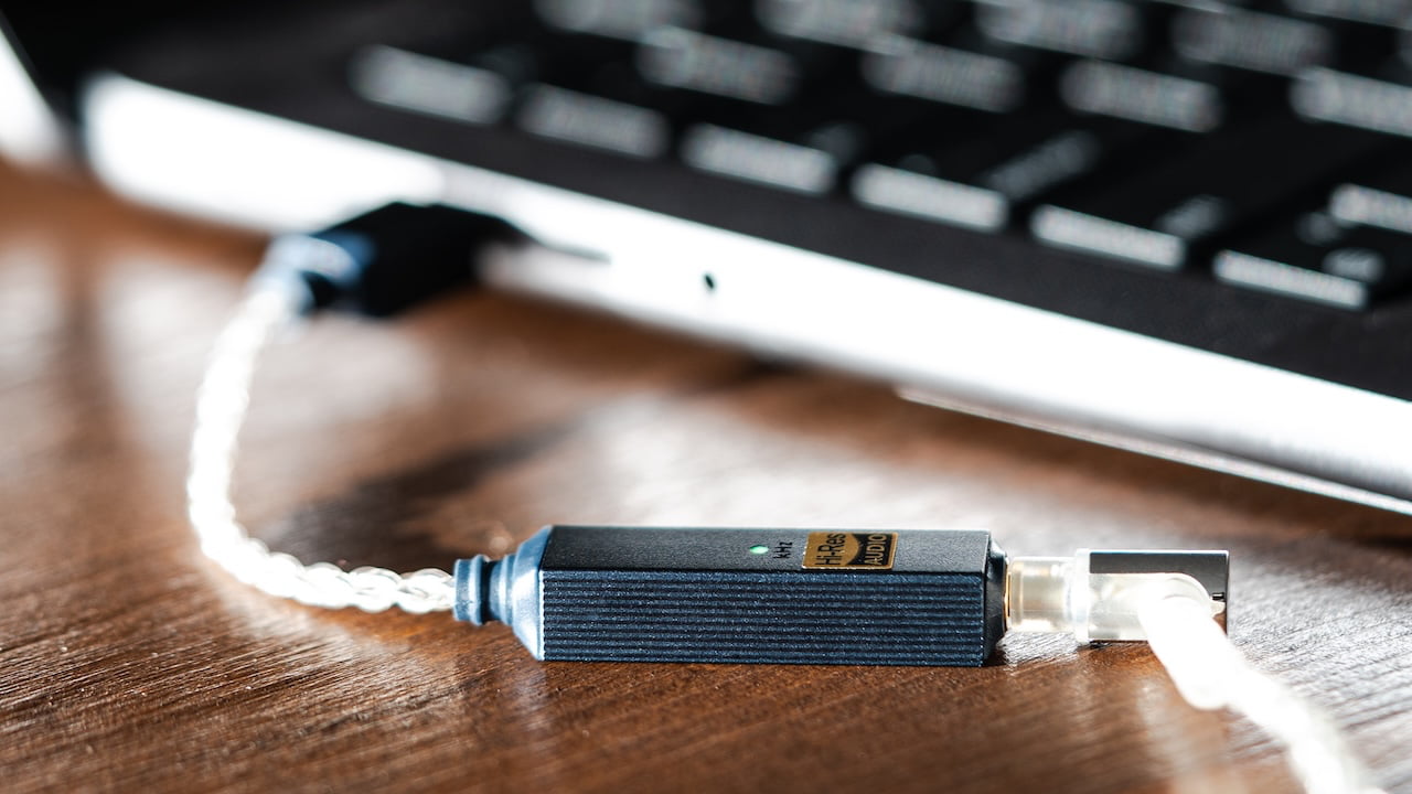

The iFi GO link 2 enters that conversation at $59, which replaces the previous iFi GO link (2023 model) that we quite liked from our testing for the same price. Although the $79 iFi GO link MAX (2025 model) adds a 4.4mm input, the GO link 2 is positioned as a wired, ultra-portable upgrade for listeners who want better sound from their smartphone, tablet or laptop without any bulk. In a segment this crowded, clarity of purpose matters. Most dongle DACs will outperform the internal audio circuitry in a smartphone or tablet, but being physically tethered to a small device that hangs off your charging port isn’t always the most elegant or practical solution.

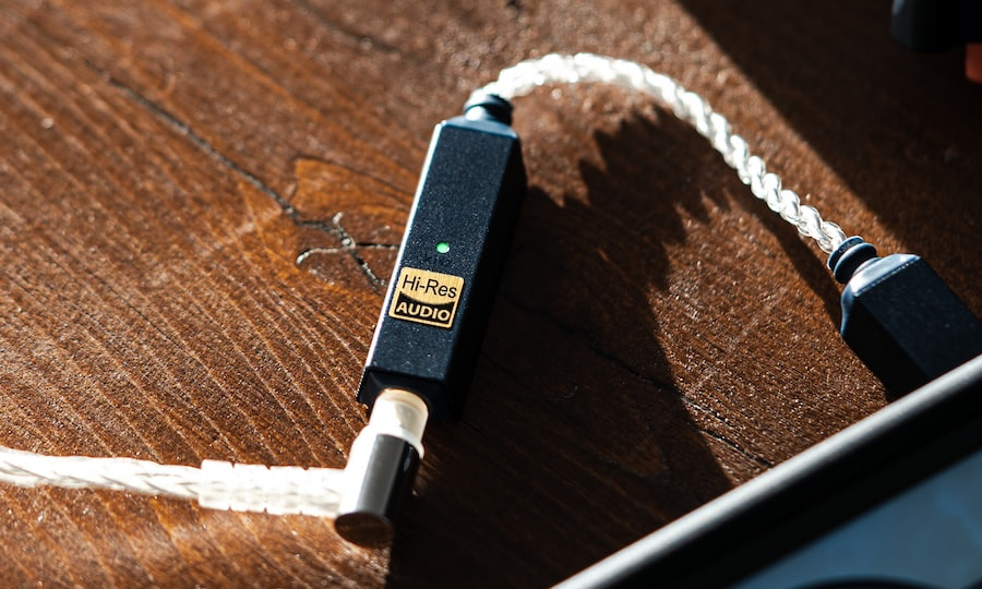

The GO link 2 is built around an ESS Sabre DAC chipset with support for PCM up to 384kHz and native DSD256, ensuring compatibility with high-resolution downloads and major streaming platforms. It is a fully wired USB-C dongle DAC with no internal battery and no Bluetooth functionality. Power is drawn directly from the connected source device, whether that’s a smartphone, tablet, or laptop.

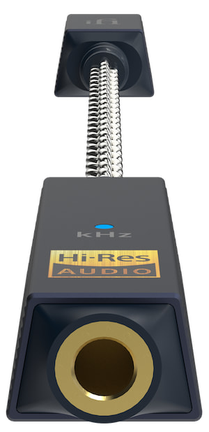

The iFi GO link 2 features a 3.5mm S-Balanced headphone output. Rated output is ≥1.59V/79mW into 32Ω and ≥2.0V/14mW into 300Ω, with an output impedance below 0.4Ω. That level of voltage and current is well suited to efficient IEMs and most portable headphones, while the low output impedance helps maintain stable frequency response with sensitive multi-driver earphones. iFi’s S-Balanced design applies balanced circuit principles to a single-ended 3.5mm output to reduce channel crosstalk, though it is not a true balanced configuration.
ifi-go-link-2-dongle-dac-top
According to the published specifications, the GO link 2 offers a dynamic range of ≥125dBA, signal-to-noise ratio of ≥125dBA, THD+N of ≤0.0015% (at 1.27V into 32Ω), and a frequency response of 10Hz-80kHz (-0.5dB). These figures place it squarely within the competitive range for sub-$100 USB dongle DACs and suggest low distortion and wide bandwidth performance within its intended use case.
Power consumption is rated at approximately 0.2W with no signal and up to roughly 1W at maximum signal, meaning it will draw modest but noticeable battery power from a connected mobile device. Physically, the unit measures 137 x 12 x 7.6mm (5.4 x 0.47 x 0.31 inches) and weighs just 7.8g (0.30oz). Its compact dimensions and minimal weight make it one of the smallest DACs in its category, designed to remain unobtrusive when connected to a phone or laptop.

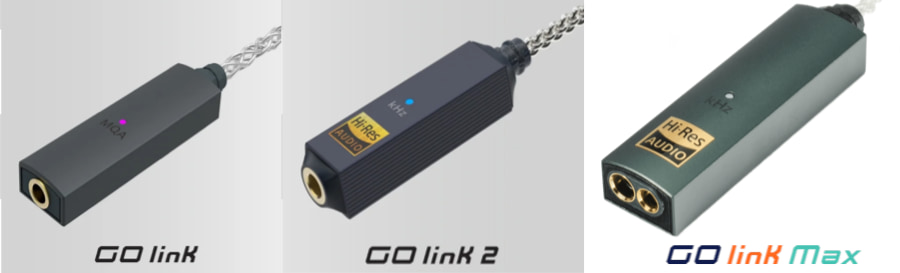

Comparison
ifi-go-link-2-max-comparison
iFi Go link
(2023 model)
iFi Go link 2
(2026 model)
iFi Go link MAX
(2025 model)
MSRP$59$59$79
DACESS Sabre ES9219MQ/QESS SabreDual ESS Sabre ES9219
DIMENSIONS135 x 12.6 x 7.6 mm
(5.3″ x 0.5″ x 0.3”)
137 x 12 x 7.6 mm
(5.4 x 0.47 x 0.31”)
150 x 15 x10 mm
(5.9 x 0.59 x 0.39”)
FORMATS SUPPORTEDPCM 384kHz
DSD256 / 11.3MHz
DXD 384kHz
MQA
PCM 384kHz
DSD256
PCM 384kHz
DSD256
FREQUENCY RESPONSE10-80kHz (-0.5dB)10Hz-80kHz (-0.5dB)N/A
HEADPHONE JACK TYPE3.5mm S-Balanced3.5mm S-Balanced3.5mm S-Balanced
4.4mm Balanced
INPUTUSB-CUSB-CUSB-C
NET WEIGHT11g (0.4 oz)7.8g (0.30 oz)14.5g (0.51 oz)
OUTPUT IMPEDANCE<0.4Ω<0.4Ω0.7Ω via 3.5mm
0.35Ω via 4.4mm
POWER CONSUMPTIONNo Signal ~0.2W
Max Signal ~1W
No Signal ~02W
Max Signal ~1W
No Signal ~0.6W
Max Signal ~3.2W
RMS OUTPUT POWER≥1.5V/70mW @ 32Ω
2V/14mW @ 300Ω
≥1.59V/79mW @ 32Ω
≥2V/14mW @ 300Ω
100mW @ 32Ω;
2V @ 300Ω via 3.5mm
241mW @ 32Ω;
4V @ 300Ω via 4.4mm
SNR≥125dBA (2.05V)≥125dBA (2.05V)≥125dBA via 3.5mm
≥130dBA via 4.4mm
THD+N≤0.004% (1.27V @ 32Ω)≤0.0015% (1.27V @ 32Ω)≤0.0015% @ 32Ω 1.27V via 3.5mm
≤0.0016% @ 32Ω 2.4V via 4.4mm
Nexis App SupportYes
