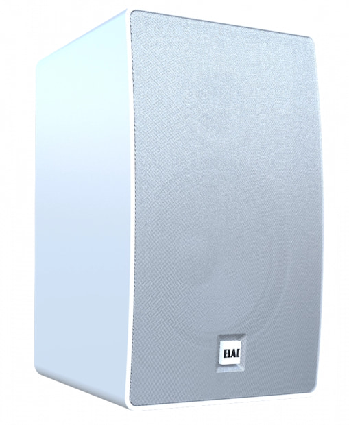

ELAC Muro OD-M61

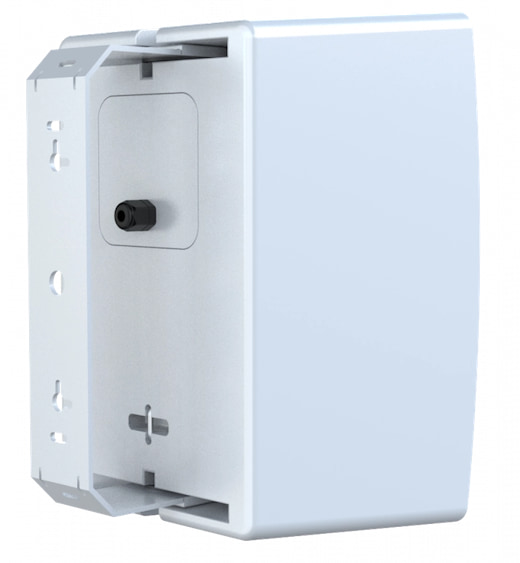

ELAC’s Muro outdoor speakers are built to fit anywhere and handle whatever you throw at it. The supplied bracket lets you mount this thing vertically, horizontally, on walls, ceilings, or even in corners. It’s like the Swiss Army knife of outdoor speakers. And thanks to the shoulder mount markings in 15-degree steps, lining up multiple units isn’t a guessing game anymore.
The back sports a tough plastic cover that hides the wiring and keeps everything sealed up tight with an IP66 rating — basically, it laughs off rain, dust, and whatever else nature wants to toss. Clean install, zero fuss.
Specifications:
  • Type: 2-Way Sealed/Ported (because sometimes you want more bass)
  • Frequency Response:
    • -3 dB: 80 Hz – 20 kHz
    • -6 dB: 65 Hz – 20 kHz
  • Impedance: 8 ohms
  • Sensitivity: 86 dB @ 2.83V/1m
  • Crossover Frequency: 2160 Hz
  • Recommended Amp Power: 30 – 100 W
  • Power Handling: 80 W nominal, 130 W peak
  • Tweeter: 25mm silk dome with 2-layer copper-clad aluminum voice coil
  • Woofer: 6.5” aramid-fiber with polypropylene cone and rubber surround (durable, tight bass)
  • Cabinet: UV-resistant plastic
  • Finish Options: Black or White
  • Port: Sealed by default, but you can switch to ported for extra bass when the weather’s nice
  • Speaker Connection: 5-way binding posts
  • Dimensions:
    • Width: 7.87” (200 mm)
    • Height: 12.2” (310 mm)
    • Depth: 9.25” (235 mm)
  • Weight: 7.7 lbs (3.5 kg)

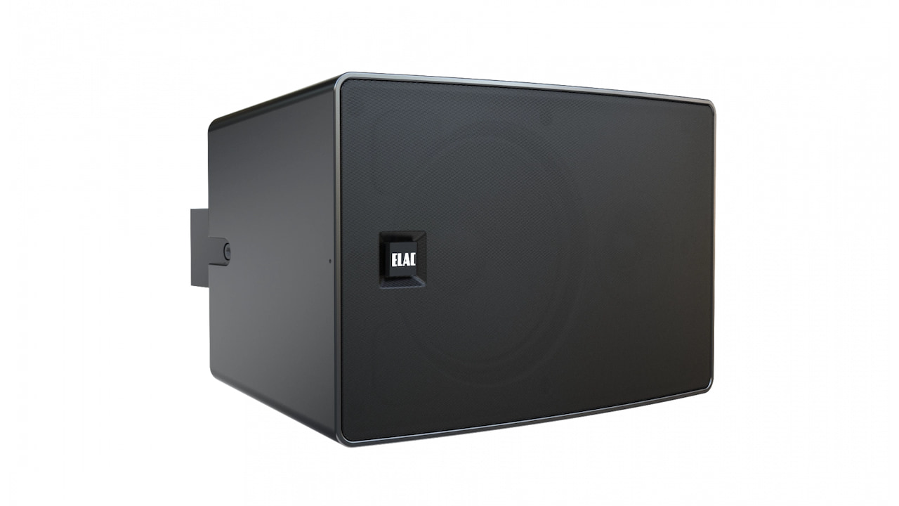

ELAC Muro OD-M81
If you’re eyeing the ELAC Muro Outdoor series and wondering why the OD-M81 costs an extra $100 per speaker over the OD-M61, here’s the breakdown: bigger woofer, more low-end reach, more power handling, and just a bit more output. It’s the same rugged, weather-resistant design, but with an 8-inch woofer instead of 6.5, and a cabinet that’s physically larger — so it moves more air and fills bigger outdoor spaces with ease. If you’re working with a large patio, a pool area, or you just want to feel the bass while flipping burgers, the OD-M81 is where your money goes to work.
Specifications
    • -3 dB: 70 Hz – 20 kHz
    • -6 dB: 55 Hz – 20 kHz
  • Impedance: 8 Ω
  • Sensitivity: 87 dB @ 2.83V/1m
  • Recommended Amp Power: 30 – 180 W
  • Power Handling: 100 W nominal / 150 W peak
  • Woofer: 8” polypropylene cone, rubber surround
  • Port: Sealed by default, with optional ported design for added low-end
  • Dimensions:
    • Width: 9.84” (250 mm)
    • Height: 15.35” (390 mm)
    • Depth: 11.2” (285 mm)
  • Weight: 11 lbs (5.0 kg)
