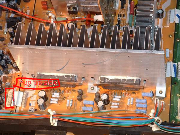

Bronze Member Username: VeasnalongPost Number: 26 Registered: Feb-07 | John, Once you pull panel ( Board supporter )and disconnect all plugs and pup up the ribbon cable plug type that connect to the outer board. then you will see all screw that hold the board down. One thing in mine you must understand Hi voltage ckt. |
Bronze Member Username: VeasnalongPost Number: 27 Registered: Feb-07 | John, For pop up ribbon cable header see picture must disconnect all around the board. ![]() |
New member Username: Bigun22Boulder , Colorado Usa Post Number: 2 Registered: Mar-07 | Veasna Thanks for the information. I have one more question. Do I remove the whole light box to get to the board or is it better to remove just the board. I need to take the board to a certified person who does soldering. Thanks |
Bronze Member Username: VeasnalongPost Number: 28 Registered: Feb-07 | Just remove the whole Plastic board holder slide out through the back but there are some (key clip)toward the front by press on them to release inorder to pull it out and unplug the wire connector then unscrew to remove the board. |
