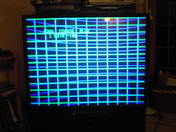

Unregistered guest | I put together a one page graphic that shows what the IC's look like and the basic board layout (excerpted from the manufacturers service manual). If you email me, I will send that out to anyone who wants it. Also, I have a complete set of schematics in PDF format for all Mitsubishi since 1999. The files are too large to email, but I'd be willing to copy and mail for a small fee. |

Unregistered guest | You can't tell anything by LOOKING at the IC's or the circuit board! The IC's are defective.... replace them! |

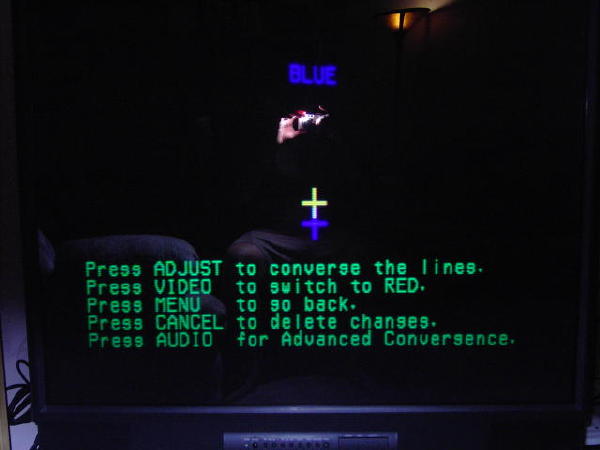

New member Username: Andy57sJackson, New Jersey USA Post Number: 3 Registered: Jul-06 | Problem: (Pictures Attached) Started having the convergence problem on my VS-45609. Had the same thing happen 2 years ago, but under warranty. At first is was intermittent, after the set heated up, now the Blue is always off (Bow-tie Affect). Solution: I received the Mitsubishi STK393-110 (Yes, I paid extra for the Mitsu Part) and installed it today. Everything went fine, but it didn't fix the problem. It is exactly as before Blue Bowtie effect. Swapped the 4 pin connectors that go to the green & blue. The green bowtied, blue was OK, proving the Convergence Blue circuitry was not working between the STK chip and the Guns. Decided to measure the 4 pin connectors to GRD. Blue was higher resistance on 2 of pins than the red/green. Measured components, they were OK. Connector VU had cracked joints. Checked all the other thru-hole connectors, at least one cracked joint per connector. Resoldered every Thru-Hole connector. TV picture is back to normal. I owe a lot to SteveLVNV, He is the Expert and helped me through all the diagnosis. Moral, replace STK & touch up ALL solder joints (especially connectors) on these TV's Thx to all, Andy ![]() |
