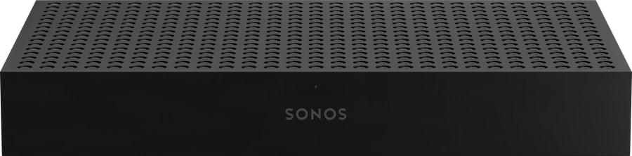

Designed to Fill a Real Installation Gap
sonos-amp-multi-front
As homeowners continue to favor open floor plans and mixed-use living spaces, system requirements have shifted—and integrators noticed. According to feedback Sonos received from the field, installers needed something that could scale with changing room layouts and evolving use cases, without adding complexity to the install process or creating friction for homeowners. The Amp Multi is the direct response to that problem: a distribution-focused evolution of Sonos’ streaming platform that prioritizes flexibility, efficiency, and long-term usability over novelty.

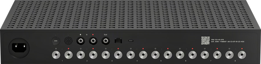

Tom Conrad, CEO of Sonos, explains the thinking behind the move: “Sonos Amp is the most widely used two-channel streaming amplifier in residential installation because it’s powerful, dependable, and intuitive. Amp Multi takes that same philosophy and applies it to larger systems. It makes ambitious designs more efficient to build and install, and easier to live with.”
sonos-amp-multi-rear
Made for Custom Installs

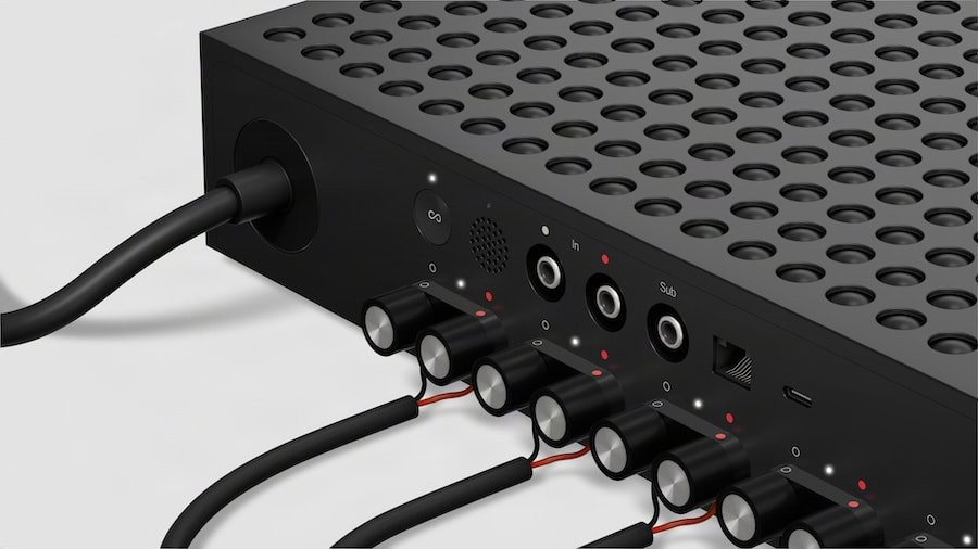

Amp Multi brings Sonos’ streaming platform and familiar control ecosystem into an architecture clearly designed for professional installers. Flexibility is the headline feature here: any output can be assigned to any zone, systems can scale simply by adding more units, and higher speaker counts can be driven without compromising stability or sound quality.
Each output supports up to three Sonos Architectural speakers, allowing integrators to build dense, efficient multi-room systems that don’t turn into wiring or management nightmares. The emphasis isn’t on novelty—it’s on making larger installations predictable, repeatable, and easy to expand as homeowners rethink how their spaces are used.
Under the hood, Amp Multi uses a high-efficiency GaN power architecture paired with Class D post-filter feedback (PFFB). The result is cleaner, more controlled sound and significantly improved thermal efficiency across all zones. Just as important for custom installs, this design enables silent, fan-less operation and long-term stability—exactly what installers want in racks that are expected to run for years without drama.

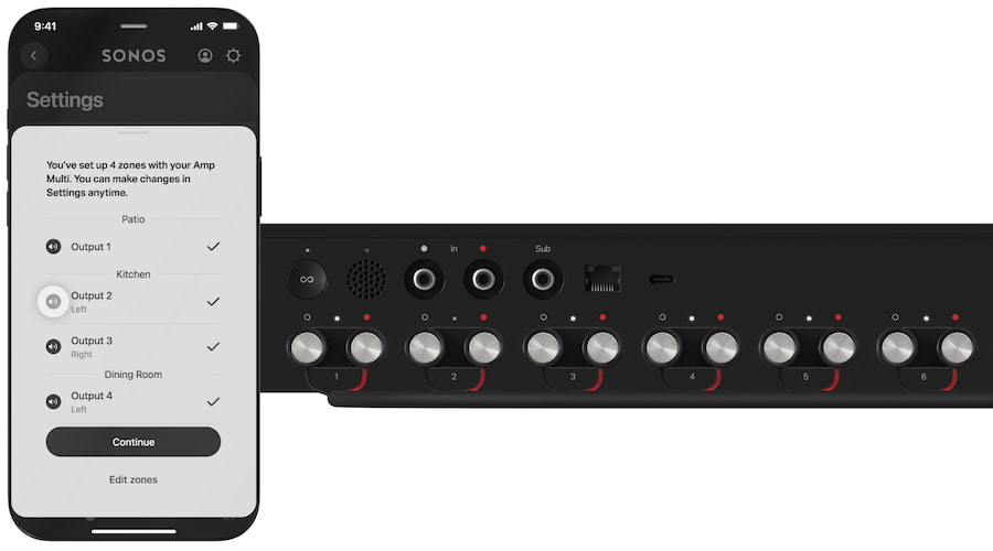

Flexible Multi-Zone Capability: Amp Multi provides eight amplified outputs rated at 125 watts each into 8 ohms, capable of driving up to 24 Sonos Architectural speakers (three per channel). Outputs can be assigned in virtually any configuration across up to four independent zones, and larger systems are easily expanded by adding additional Amp Multi units. The result is a platform that adapts to the scope of the project rather than forcing installers to work around fixed limitations.
Fast, Non-Nonsense Setup: Each unit emits a unique audible chirp that’s triggered directly from the Sonos app, removing the need for manual PIN entry and the guesswork that comes with identifying hardware in a rack. From the same interface, integrators can quickly manage zones, sources, and output assignments, streamlining configuration and cutting time on-site.

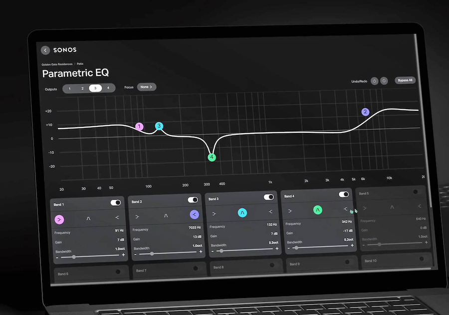

Advanced Tuning and DSP Tools: Amp Multi also introduces ProTune, a new manual sound-optimization suite built specifically for installers. ProTune provides granular control over each output, including a 10-band parametric EQ, gain, width control, and delay offset. This allows precise tuning for difficult speaker placement and complex room geometry. In parallel, Optimize Sonos Speakers applies detailed DSP profiles tailored for Sonos Architectural speakers, ensuring consistent performance without guesswork.

Rack-Optimized Layout: This approach eliminates the need for extra vent panels while maintaining proper thermal management and clean cable routing. For integrators building dense racks, it’s a small but meaningful design choice—one that keeps installs tidy, reliable, and serviceable over the long haul.
Efficient Installation: Amp Multi’s flat-back design and recessed connectors allow the unit to stand upright while the Rack Mount slides into place. The install process requires only eight screws, making projects fast and predictable.

ProTune Signal Processing10-band parametric EQ with ±15dB gain, Q, and frequency control.
Option for high-shelf, low-shelf, and bell filter types.
Gain trim: -15 to +5 dB
Delay: 0 – 50ms
Highpass: 15-100Hz
All available on per channel basis
