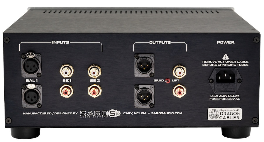

saros-europa-tube-headphone-amp-rear

The Saros Audio Systems Europa isn’t just another “balanced” headphone amplifier—it’s a true fully differential design from input to headphone drivers. That means no sneaky single-ended conversions hiding inside the chassis. The result: lower noise, better channel separation, and a soundstage that doesn’t collapse when things get complicated.
At its core, the Europa runs a differential circuit that operates fully balanced when connected via XLR, and in standard differential mode when using single-ended inputs. A ground-lifted topology helps prevent hum and interference from sneaking in through the signal path. It’s a complex way to build an amplifier, but it’s what allows the Europa to maintain symmetry and transparency all the way through.
Power and control come from a lineup of five premium vacuum tubes—two 6922s in the preamp stage (6DJ8/ECC88/6N23P equivalents), two 6H30P driver tubes, and a 6BW4 rectifier tube in the power supply. Supporting them are five Lundahl transformers, each dedicated to a specific function in the input, driver, and output stages, as well as power supply and choke filtering. These are wound in Sweden and selected for their low noise floor and linear response.

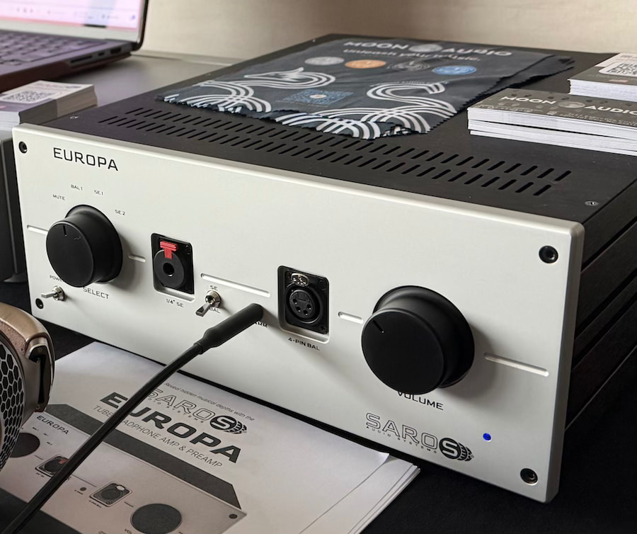

saros-europa-angle
The Elma 24-position stepped attenuator (with a 48-step upgrade option) handles volume control with precision that cheap pots can’t match. In the signal path, VPG ultra-precision Z-Foil resistors and Mundorf capacitors (both electrolytic and MKP) keep the noise floor clean and the tonal balance consistent. Moon Audio’s Bronze Dragon wireties the signal chain together, while Acoustic Sonic Barrier dampening keeps microphonics and mechanical vibration in check.
The power supply gets the same level of attention: a Lundahl power transformer feeds the rectified output from the 6BW4 tube, followed by heavy filtering via Mundorf capacitors and an additional Lundahl choke for ripple suppression. Even the DC rails are filtered with Panasonic capacitors for stability. The Constant Current Source (CCS)implementation on both triode stages ensures linear performance and allows fine-tuning of the push-pull configuration for optimal output.

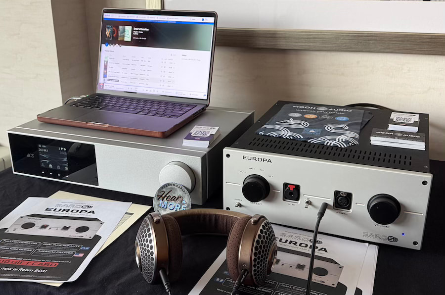

saros-europa-with-audio-technica-ath-adx7000
