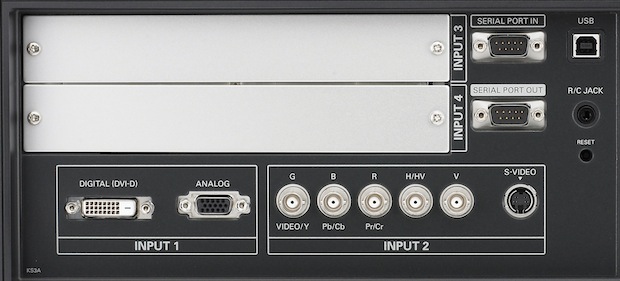

Sanyo PLC-XF1000 3LCD Projector - Inputs

  • Input Terminals: DVI-D (HDCP), RGB D-sub 15-pin (input and output),
  • RGBHV/Y/VIDEO, Pb/Cb,Pr/Cr (BNC x5), S-video
  • Control: RS232C (in)/ D-sub 9 x 2 (out)
