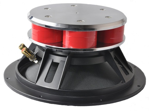

B.M.C. Audio Arcadia Woofer

B.M.C. Audio custom designed all the Arcadia's drivers. They feature honeycomb-Kevlar cones that are light, stiff, and free of resonance and coloration. Rather than use the traditional single magnet per woofer, B.M.C. Audio embedded each Arcadia woofer with 6 magnets arranged in a ring. This yields an exceptionally dense magnetic field for long linear excursion range of 0.27 inches.
