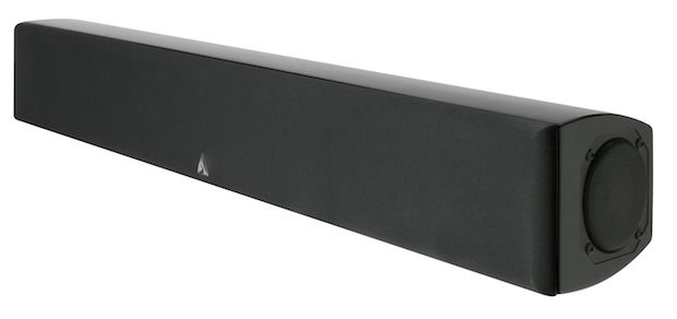

Atlantic Technology FS-7.0 Surround Bar - Side
The FS-7.0 is capable of reproducing a full seven channels of home theater audio thanks to a creative assemblage of technologies and drivers. The speaker’s front baffle includes three 1-inch soft dome tweeters, each of which handles the upper frequencies for one of the front LCR channels. Also on the front panel are a pair of 4×6-inch woofers, each featuring dual voice coils that allow these two woofers to reproduce all three of the front soundstage channels’ upper bass and midrange reproduction. The left driver reproduces the left front channel and half of the center channel, while the right driver handles the right front channel and the other half of the center channel. This arrangement saves cabinet space and maintains a trim enclosure. The LCR treble is handled by the three 1-inch tweeters.
For the surround channels, the company has designed a unique pair of full-range 3-1/4-inch drivers mounted at either side of the cabinet. Each driver has been situated at a very precisely determined radiation angle to maximize the immersion of the surround field by taking advantage of reflections from the front and side walls of the theater. Additionally, each of these patent-pending drivers features a triple voice coil design, allowing them to reproduce both the side and rear surround channels, as well as incorporating a portion of the front left and right channels to impart a greater sense of spaciousness to the front soundstage. The end result is an impressively immersive surround field that is compatible with any multichannel receiver or processor in existence.

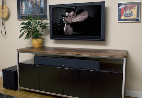

Atlantic Technology FS-7.0 Surround Bar in Room
Atlantic Technology FS-7.0 Surround Bar and SB-800 subwoofer
The final component in Atlantic’s compact multichannel surround system is the addition of a powered subwoofer to reproduce the special effects and deep bass signals that drive much of the home theater experience. While the FS-7.0 system is compatible with any subwoofer, Atlantic has designed a model specifically for this system. The SB-800 is a compact, but powerful, 100-watt subwoofer with a long-throw 8-inch woofer that is capable of linear output down to 32 Hz, and output of up to 103 dB in a 2000 cubic foot room.
The Atlantic Technology FS-7.0 and SB-800 compact theater system will be available in September at a suggested retail prices of $800.00 for the FS-7.0 in Gloss Black and $300.00 in matte black for the SB-800 subwoofer.
