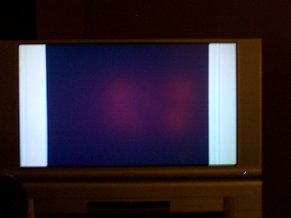

Our blue blob (right top hand corner) and red cloud (large in the centre of the screen) journey has begun.
Thank-you to all who have posted as undoubtedly, we would also be paying for the light engine.
Sebastien was the call taker this morning after calling 1-800-hitachi. He was professional, not overly friendly but obviously well-scripted. He refers to no recalls at this time, etc etc. He would not commit to any diagnosis claiming one cannot be made over the phone.

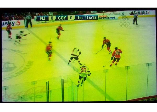

WHAT A GREAT FORUM, I just took my Dads 42v515 that had bad image issues, Yellow center hue when cold and overpowering Blue hue/blob when warm.
After cleaning the lamp, lens and main mirror the image was a little bit better. After reading many forums and results, i decided to call Hitahi (Tv is 3 yrs old , Dec 2004) even though i didnt have the extended warranty.
The Customer service Rep i got was excellent (honestly)and after a 2 minute discussion she agreed to send a new light engine if it was diagnosed by a TV tech, I told her that i didnt want to pay for a Tech to look at the TV for 2 seconds and then tell me Yes it needs a Light Engine, and that I was a service Tech certified by other Electronics companies and had a strong electronics background and that i was willing to install It myself if shipped to me directly, she put me on hold for maybe 2 minutes and came back and said they would cover the light engine and labor once a Tech verified it, She even allowed me to have the repair Shop I wanted to look at it. They took 1 day to fax the info to the TV repair company, and then took another 3-4 days to ship the Light engine, the tech just put it in, and only needed a signature.
I have always been a Sony guy, but honestly this was a great resolution to my issues and Hitachi has moved up to the short list of manufactures that i would prefer to deal with.

First pic shows the nice red cloud.
Second pic can't even make out the 08 because of the cloud...this was from an HD cable feed.

The problem has progressed to where the color is mostly chartreuse over most of the picture. Does this sound like a light engine?Upload

We have a 50VX500. We have blue around the edges of the screen, like a blue picture frame more prominent on dark images. What button do I have to press to see the 480I, 480p, 1080I and so on displayed on the tv? In the service menu it shows 19411 total. It cant be hours cuz I can see it change several times. I saw a lamp time reset but no lamp time values.
