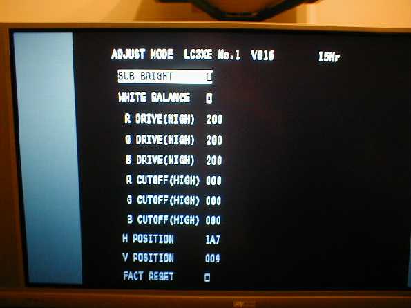

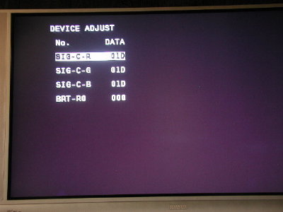

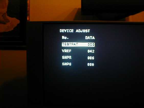

New member Username: JobmnMinneapolis, MN Post Number: 3 Registered: May-06 | Per prior messages, I entered the service menu and checked the LCD Driver values... they were 000's for red and green. Reset them back to the default levels per the service manual (I'm glad I downloaded all 14 parts), and all my reds were back! I saved a $50 initial visit from the repairman for diagnosis +++ whatever they decided my unit needed replacing (Another $50 trip charge, $299 repair labor charge + parts). Since I don't watch the 50V500 that much (less than 300 hours after two years) maybe it will last me a long time. When it is good it is really good. |
Silver Member Username: John_sColumbus, Ohio US Post Number: 946 Registered: Feb-04 | Congratulations Joe! ![]() |
New member Username: Sboone03Post Number: 4 Registered: May-06 | Joe - Can you tell me how to get to the menu where I can change the values? I am unable to download the manual for some reason. I can get to the service menu and then to LCD Drive but I cannot tell where to go from there. John S. sent me the values in a link above but I can't find them in the menu. Can you help? |
New member Username: JobmnMinneapolis, MN Post Number: 4 Registered: May-06 | William This is where you can get the service manual http://www.eserviceinfo.com/downloadsm/13164/Hitachi_50V500.html You have to download all 14 parts and the have a program that can handle rar files. I downloaded and used winace to extract the manual, available at www.winace.com When you do this you will get a 35 MByte Adobe Acrobat copy of the manual... all 194 pages |
New member Username: Sboone03Post Number: 5 Registered: May-06 | Thanks Joe, I now have the service manual but I still can't get to the place where I can change the values. I go to LCD Drive and cursor to the right to get to the sub-menu and here is what comes up: TESTPAT 000 VREF 050 SHPR 006 SHPG 005 SHPB 006 NRSH HR 350 and about a half dozen more like that. How do I get to the: SIG-C-R 01D, etc. so I can reset those codes? What am I doing wrong? I can't find anything in the manual that helps. I have all the right codes, I just can't find where to put them in. |
New member Username: Zepp36Colorado Post Number: 2 Registered: Mar-06 | That's puzzling, William. You're doing everything right...down arrow with remote control select button to highlight LCD Drive then right arrow to sub-menu...you should get what is pictured below... ![]() |
New member Username: Sboone03Post Number: 6 Registered: May-06 | Thanks Dave. I've been trying to find that but I can't. Does it have anything to do with the cable box being on or off or having the TV set on Ant A or one of the inputs? |
Silver Member Username: John_sColumbus, Ohio US Post Number: 955 Registered: Feb-04 | Yes indeed, thanks Dave. In an effort to help William, plus familiarize myself with the service menu for possible future use, I tried to find the "Sig" adjustments there. Unfortunately, like William, I had no luck either. I tried everything I could think of, including different inputs, with and without an incoming signal. Every time I scrolled down to "LCD Drive" then went right, this is what I see: I can then scroll down to some other stuff on this sub-menu, but no "Sig" adjustments. . |
New member Username: Sboone03Post Number: 7 Registered: May-06 | Thanks John. This is exactly what I get as well. |
New member Username: GaryPost Number: 3 Registered: Dec-03 | Has anyone attempted the Mem. Init. in the 50V500 Service Menu? If so, what does it correct and are there any disadvantages/adverse effects of doing this. Thanks. |
Silver Member Username: John_sColumbus, Ohio US Post Number: 957 Registered: Feb-04 | William, if you look on page 64 in the service manual, you can see the "Sig" adjustments listed immediately under LCD drive (Sub mi-com)...whatever that means. I just don't understand why it's not coming up. ![]() |
New member Username: Sboone03Post Number: 8 Registered: May-06 | Same here John. I've tried everything so I guess I'll bite the bullet and call a technician. |

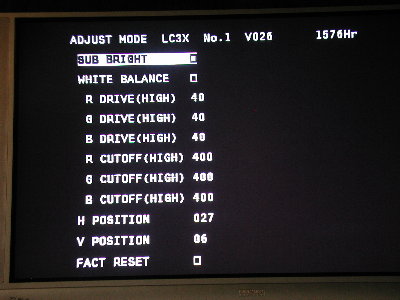

New member Username: Zepp36Colorado Post Number: 3 Registered: Mar-06 | Wendy, your repair experience went almost exactly the same as mine (March 23 post). Glad it worked out. I've had my replacement LE in use for over three months now and everything looks great. I'm still puzzled on the differing service menu sub-menus people are seeing. I get the SIG adjustments when I cursor right from LCD Drive, but others get TESTPAT. Perhaps there are different software builds. My set is a 50V500 manufactured in Sep. '03. Photo below is the first page of my service menu that I took several years ago for reference. The top line numbers are the same today (except hours)... ![]() |
New member Username: Sboone03Post Number: 9 Registered: May-06 | Dave - I checked my top line numbers and they are all different, as are the settings. The top line is LC3XE and V162 so it must be a different version. I have checked every menu and sub-menu on mine and there are no SIG adjustments. I also did a brief search on-line for a different version of the service manual but came up empty. Any ideas would be appreciated. |
Silver Member Username: John_sColumbus, Ohio US Post Number: 959 Registered: Feb-04 | Yes gentlemen, I think we're making a little progress here. My 50V500A was manufactured Sept '03 as well. There was much discussion about what the "A" means a couple of years ago on this thread. William is yours an "A" model too? In any case, here's my first page, which is the same as Williams: Sorry about the quality....I need to update my ancient camera. By the way, I just took this today. I did a FACT RESET last week which resets the bulb time. It should read about 950Hr. I also had to reset all my color settings. |
New member Username: Sboone03Post Number: 10 Registered: May-06 | Yes John. Mine is also an "A" model and was manufactured in December '03. Sounds like we may be getting somewhere? |
