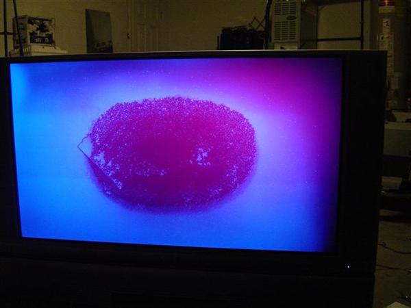

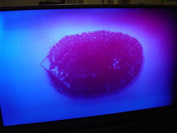

Well it seems i have found my way here as many other Hitachi 50v500 owners have, a neighbor was going to throw out their Hitachi so me being the fix it type, I decided to grab it.
I plugged it in a immediately noticed "the blob" but mine seems to be a little different than the ones I have seen pictured on the forums.
It also has no other colors being displayed but blue, and tons of dead pixels.
Just wondering if you guys think this is just an extreme case of a bad LE, or if has other problems as well. And a big thanks to all the posters in this thread, it has already saved me countless hours.
Username: Tv_mike
Post Number: 28
Justin,
This definitely looks like a bad LE to me. Although this is the first I've seen this on the Hitachi, this was a big complaint with the older Sony RPLCDs. They refer to it as the "Road mapping" problem.
I would get John S' opinion on this as well but it almost looks like what the red cloud issue could become if it was left alone.
You can see this on the "Sony Rear Projection TV Problems" thread. https://www.ecoustics.com/electronics/forum/home-video/137540.html
I don't recall anyone fixing it without replacing the Light Engine.
Good Luck!

Michael and Justin;
Yup, this is a bad one. Looks like an Hitachi blob mutating into a Sony roadmap. To my knowledge, the Sony roadmaps almost never cover as much screen area as the Hit. red blobs. Also, I have no idea what the determined cause of the roadmaps is, but the conclusion on the blobs is overheating caused by inadequate ventilation.
Justin, you may be able to get Hitachi customer relations to cover the LE while you pay labor (about $300). If so, you have a good bargain TV. If not, this TV isn't worth the $1500 or so to repair it, imo. For another grand, you can get a far better display new these days.

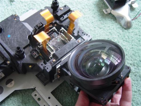

Alright, so if you read my posts above you saw the extreme case of the blob i was experiencing when i rescued this 50v from the trash.
I contacted Hitachi, and after a bit of talking they were pretty quick to offer me a new part for free, so no problems there. they even shipped it 2nd day air (kudos Hitachi:-))
Any way, long story short it will be here tomorrow and I'll be installing it myself, and take detailed pics for all of us here. Its not that difficult. I pulled the old one out in about a half an hour.

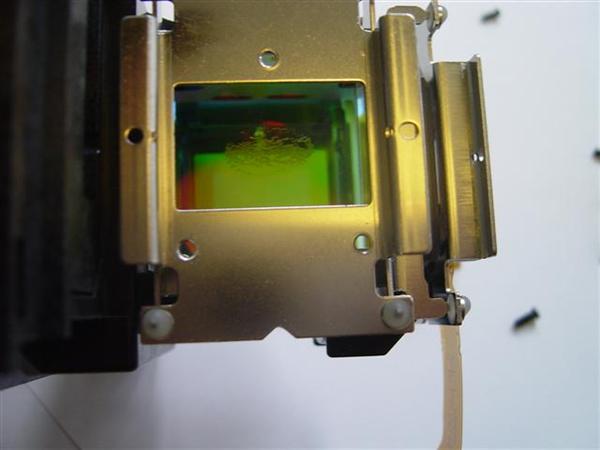

So on with the show... First thing i wanted to do is find out exactly what is failing and why, we are all pretty aware that the ventilation on these TVs is not adequate, so lets take a look...

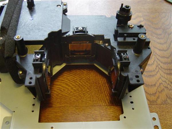

Here is the entire optical engine or light engine assembly, this one is part# ux22201 (OEM original) The two vented boxes on the top are the LC3X drive board and the FC4 LCD board, to the right of those you can see the fan and duct system for the light bulb, above the PWB's you can see the lens that projects the picture to the screen.

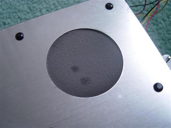

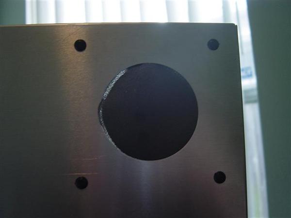

Flipping the entire optical engine over, under the PWB's you can see the intake port for the cooling fan that cools this beast down.(notice the dust) The problem with this is that there is only about an inch of clearance between it and the bottom of the set.
Here you can see how much dust has accumulated inside the filter, I shifted it over slightly to show a clean portion of the filter. Sunlight doesn't even penetrate through it. When this was running there was almost no air flowing at all. On a side note if you are not experiencing the blob plague yet, cleaning this periodically will practically solve your problems... well some of them any way.

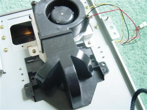

Underneath the intake cover, you can see the ducted fan that cools down the LCD panels and the other optics.

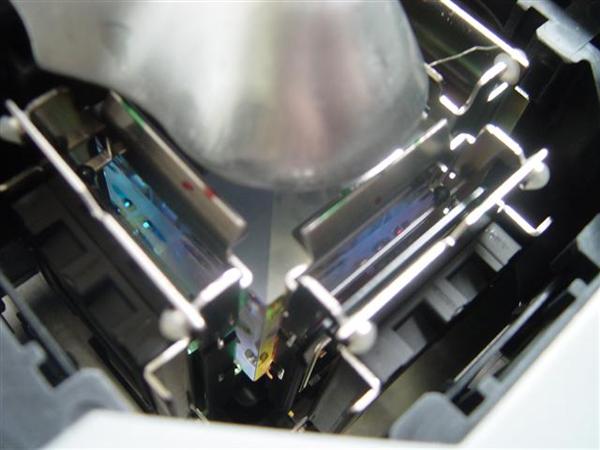

Underneath the ducts, you can see the heart of the beast and the affected components.

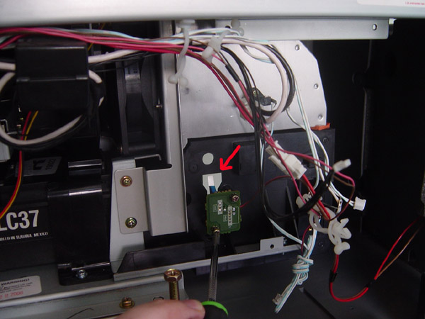

Flipping the unit over and removing the drive boards, this should give you a better road map for the layout. The three ribbon cables are attached to there respective red, blue, and green LCD's these in turn attach to the LC3X drive board.

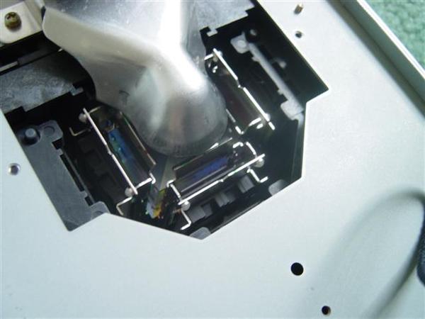

On to heart surgery, here with the assembly removed, you can now see the LCD screens. You can also see why another big name manufacturer is having similar problems with there light engines... Yep that's right the Lcds are made by Sony.

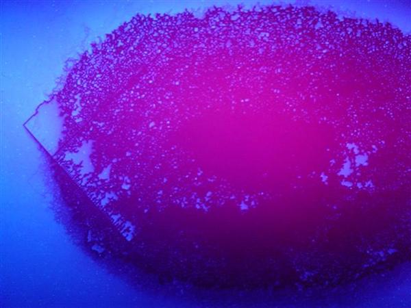

After completely removing the LCD you can see the "blob" in all its glory, yep thats it, less than an inch big in the center of the LCD there. If you are having minor Blob issues, this is your culprit. The extreme heat from poor ventilation is frying the LCD.

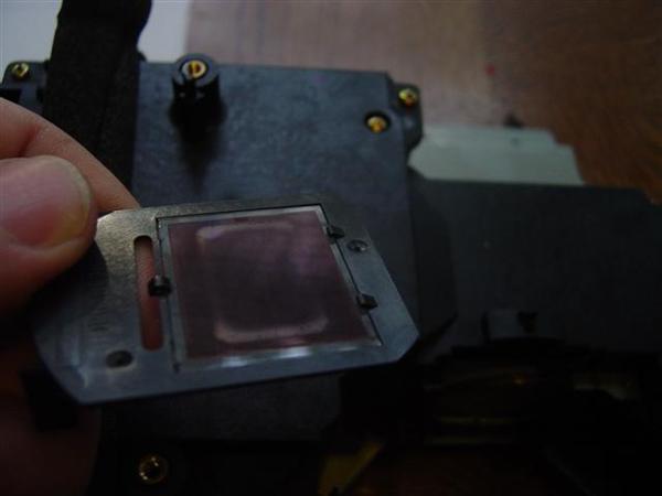

In my case of the extreme blob, the heat was so great it was destroying one of the filter lenses, it actually has physical cracks running through it which were reflacting the light to give the super blob effect.
You can see the result of the damage here
Moving on to the rest of the unit, you can see more damage caused by the heat, here is the portion of the assembly that reflects all the light from the bulb to the LCD's
More heat damaged components, this is the green lens, if you look in the top right corner you can see what appears to be some sort of fuming issue.
Another damaged filter...
So now we know whats wrong and why, when my new light engine arrives tomorrow, I will go into what changes were made, and see how well airflow is improved. I am also dying to know if they are still using the Sony LCD's.
After all is said and done, i would like to add some well placed fans inside the unit to help keep it cool, And then post a step by step on how to install the unit. All it takes is two Philip's screwdrivers.
J.

Thank you so very much for the explanation for the "super blob". I've had my 50V500 since March '04 and am also a member of the 'red blob' club. However, when I tried to attack the problem back in '04, I had no luck. It's such a relief to hear that they're now taking accountability. The "super blob" just reared it ugly head on my set yesterday. I called Hitachi and of course they're "recommendation to me" is to call a tech, get a diagnoses (which is totally ridiculous to pay $$ when I already know what is wrong), and then call them back so they can assess my "individual situation" to see exactly what they're going to do.
My question to you is how on earth did you get them to agree to replace you LE without having a tech involved?
My husband and I have decided that if we can get our hands on a new LE, we're going to replace it ourselves. With the numerous websites and sharing of others experiences, it should be a breeze. I hope!

Username: Cbcooldad
I too am having the "Red Cloud" issue. I am out of warranty also. After reading post after post, I decided to experiment a little. I found that I have 4800+ hours on mine but reset it on accident. I guess I shouldn't mess around not being familiar with the menu. I did however go back to the regular menu and found 2 different "red" adjustments. I turned them both down to about 20 and the red cloud faded. The picture is still good too. It is still there but maybe I can put up with it until I can see if Hitachi will replace the LE. The lamp seems to have dimmed over the last few months so I am looking into replacing it in hopes the picture will brighten up. I will be having a tech out next week to "try a few things first" but I am fearing a LE replacement.
Username: Brjabu
anyone know anything about blue clouds? i assuming they are the cousin to the famed red clouds and would need the same intervention... i contacted my hitachi repair guy and explained the problem to him... he is ordering me the part, which i assume is the LE. he warned me the part was going to cost around 500, does this sound right???? any insight would be helpful. thanks.
Username: Wendypoo
Brendan,
We had the terrible blue blob and over the course of a year it grew to cover over half the screen. We got a new light engine - part paid by Hitachi after we followed advice on this forum on how to deal with Customer Relations - and now the set is better than ever. Good Luck!
Username: Scherisho
Hey all, I have a 50V500 and I noticed I have the red blob issue. This will be the 3rd service call to sears with my EW. They told me when I called the 2nd time if I call three times they will replace the tv. I understand the cause is the light engine. That being said, sears warranty states they will replace the tv if 3 service calls are placed within the EW tim frame. I really like my tv and I don't want to be given a replacement that inferior to my current TV. Do any of you have any suggestions of models that meet the current features of the 50V500? Is the new hitachi 50 inch LCD tv just as good as the 50V500? Any advice is appreciated since I want to be prepared when I talk to sears.

Initially I had this issue, there is a pressure switch in the top right hand corner of the lamp receptacle on the TV. I found that even though I thought the new lamp was seated correctly, I had to push it back even further. The Lamp should be touching the outer housing of the receptacle, this will activate the pressure switch and you should be able to power up normally.

Here's a pic of the switch, it is activated by being pushed back, or in the case of the picture toward us.

I called CR and told them about the blotch and that I would love to be a lifelong Hit. customer if they made this right... 2 min later the guy came back and verified my address for delivery.
Sears is going to come out and do the replacement for $212 minus what i already paid.. so $103...
Voila.. new TV. Hope ur experience is as good as mine.

Username: Karlos1211
Tech confirmed it was the blue LCD in the LE that was bad similar to the one in the pics above, just a different color on my screen than you guys with the red blob. My blob was yellow on white screens, green on light blue screens and a deep blue on blue screens. After calling Hit 4 times they finally agreed to cover half of a refurbished LE and sent it to me right away even though they insist there is not a flaw in this model's (42V715) LE. Installed it myself in about 2 hours and after some fine tuning in the service menu it's good to go. We'll see how long it lasts. This post was a great help even though I have a 42V715. Thanks!
