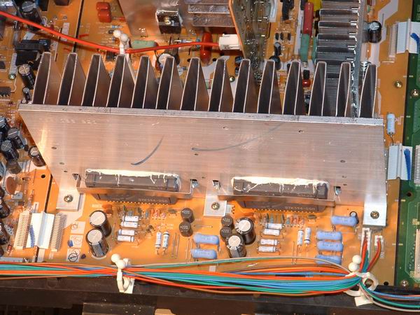

New member Username: KodukulaPost Number: 3 Registered: Jan-07 | Yesterday, I replaced two STK 392-570s as per the instructions in this forum, and got rid off bow tie / hour glass effect. I have perfect picture now. Thanks to Steve and others. The local repair guy was not sure how much it was going to cost me, but guessed in the order of $400 to $500. Not only I saved this money, but it also gave me the satisfaction that I could do it myself. Like everybody stated, the hard part was getting the board out. It took me a while to figure out that I needed to remove metal bar out on the heat sink first, before I could reach the mounting screws for the heat sink to the PCB. I used a mirror to see these and it did help a lot. I am all set to watch the play-offs today. Thank you all! |

New member Username: Swaper1Post Number: 1 Registered: Jan-07 | Hey I have read all the info on the ics and have followed the procedures for replacement of these chips but I still remain with the same problem with the 3-D look on the set. When I try to aling the red and blue they do not move. Any help would be great. Oh yea my TV is a vs60703 and im not sure if this is any diferent than the sets in here or not. My ics are skt392-110 and were not the 5.99 model Iv been hearing about. Could realy use some help on this, Thanks | |

New member Username: OlliehdtvPost Number: 1 Registered: Jan-07 | Well, I finally decided to swallow my pride, and muster up some humility to post. My story is not as pretty as most that I have read here on this message board. My TV had been down for about 3 months. I worked on it when time was available, using the guidance of this board. I had contacted Steve a couple of times, he offered great advice. (THX STEVE). Anyway, I got tired of messing with it, and took it to a pro to work on. Removing the Lite Box saved me 100 dollar pick up and delivery fee. So, the service center told me that, the convergence IC's I had soldered in were fine. They told me that the RED tube had blown out, and Mitsu does not have these parts available anymore, and even if it was available, you couldn't just replace the RED tube, you'd have to replace the blue and green at the same time, due to phosphor burn in. So long story short, my TV is pretty much worthless. So here's my thought. Either, I get a whole lite box from someone that has had something go wrong with there screen (scratched or cracked) or chassis. Or there is nothing wrong with my chassis or screen, sell that to someone who needs it. I'd prefer to just buy a used lite box, my convergence board is good, so if you could guarantee me that your "guns" or tubes are good, I'd buy the Lite box from you. What we need is a MISTU TV parts junk yard. LOL.... Anyway, I realize I'm grasping for straws, but I love this TV, and really don't have the funds to purchase a new one. I have a 65" WS65857 Any suggestions would be great. THX. Ollie |
New member Username: DmgceoPost Number: 1 Registered: Feb-07 | I'm about to try and replace the two convergence STK392-570 IC's with new ones. From those who have posted here, I think I understand the removal process - but - do I solder the new IC's in their sockets FIRST then put the heat sink back on and screw it down or put the IC's and heat sink back on then solder the IC contacts ???? help!!! | |
New member Username: AdpantherSan Jose, CA Post Number: 2 Registered: Jan-07 | Well I just finished with mine today. My Tv is a little different I had one 27pin STK IC STK393-110 Steve helped me with the part number. Anyhow I had no experience soldering so I had to spend about $60 for equipment (MCMINONE.COM) and $20 for the IC (ELECTRONIX.COM) I took apart some old electronics that I had around so I could get used to soldering on pcb. Spent about two or three hours getting used to desoldering and soldering. O yeah and 14.50 for the manual (USER-MANUALS.COM) <------ This was a very high quality pdf BTW I removed back cover removed three pieces of wood 1 rear and 2 1 on either side of light box. Removed speaker cover and panel. Disconnected three connectors from front of tv. I removed 3 screws from light housing. Removed Entire Light Box. tried to tip back but center CRT PCB would not allow it. Had to disconnect all wire ties release chassis, slide out and tip up chassis to access bottom. The plastic chassis allowed barely enough room to access pins. I tried to use a desoldering pump but with the pins so close together I could only effectively desolder 3-4 pins. So I went to a #1 Braid. After a while of frustration desoldering while lying on my back the old IC was free. I tipped Chassis back down and removed cover over IC mounted to Heatsink ( most of your tvs don't have this I understand.) I used a knife and cut through the heat sink paste and removed the IC. I cleaned all surfaces of both sides PCB, heatsink and new IC with Alcohol. I had to remove the heat sink to insert the pins but found it helpful to remount the heatsink with paste becuase it held the IC in place. { Tipped it back up and soldered it in. Reassembled everything. Took about 4 hours not counting practice time. I cleaned the lamps while I had it out and it looks better than it did when I bought it. I had to reset defualt convergence when I turned the tv on Scared me both red and blue were off before I did this. I also have a small dirt or debris particle on the back of the lenticular I have to clean off in the next few days. Thanks for all the posts everyone I would not have paid someone to fix this and it would have broken my heart to throw it away I wish I would have had more experience and a helper would have been handy. Plus accidentally melting plastic on the chassis 8 inches from your face doesn't smell good. Dave |
