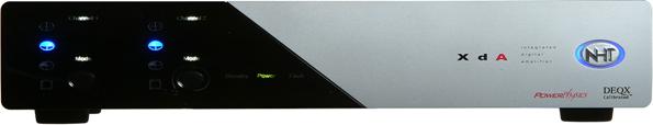

NHT’s proprietary workhorse is the XdA. In one slim box it has a DEQX-calibrated DSP (digital signal processor) and PowerPhysics One-Cycle Sound Class D (4 x 150-watt) amplifiers. Each XdA powers two speakers, and connects to one or two XdW subwoofers. In simplistic terms it optimizes the signal before it’s sent to each speaker. However, a technical explanation is available here.

Despite the complicated aspects of the XdA, it’s quite easy to control. Its front panel amp has just one button to press for each speaker channel, which correlates the position of each speaker connected to it. The four options are:
  1. Near a wall
  2. In a corner
  3. On top of a TV
  4. Away from walls
Once set, you never have to touch the XdA again. Each speaker channel is set individually. They don’t all have to be set to the same option. The XdA corrects the signals sent to each speaker based on the setting selected, essentially changing the sonic characteristics of each speaker. The point is, your system can still sound incredible even if any of your speakers have to be placed very close to a wall or on top of your TV. Although, ideally all speakers should be placed at least 2-3 feet away from any wall. The “speaker correction” processing allows greater compatibility with any room and provides more flexibility in speaker placement, which interior designers and spouses generally appreciate.
