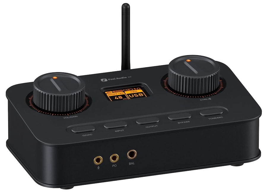

fosi-audio-k7-dac-amp-angle

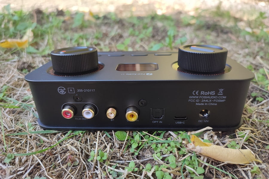

fosi-audio-k7-dac-amp-rear

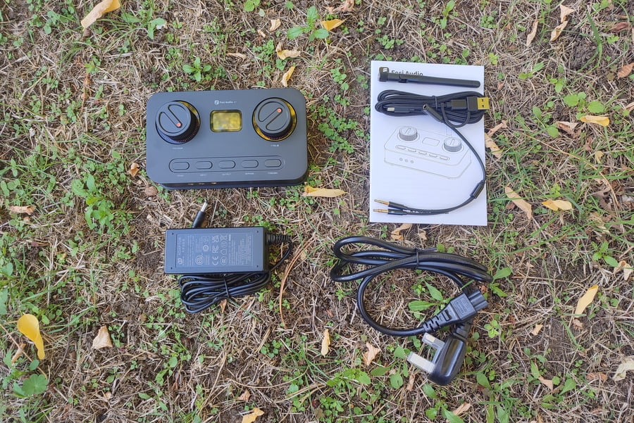

Included in the box with the K7 is everything you actually need: a USB-C cable with an attached USB-A adapter, a 12V DC power supply, a 3.5mm headphone splitter cable for microphone use, and the usual user manual.

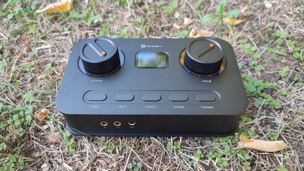

Fosi Audio has also made a smart call on build quality. The K7 uses a full CNC-machined aluminum alloy chassis, which is still the exception rather than the rule at this price point. It gives the unit a reassuring sense of density and durability that cheaper plastic enclosures simply don’t manage.

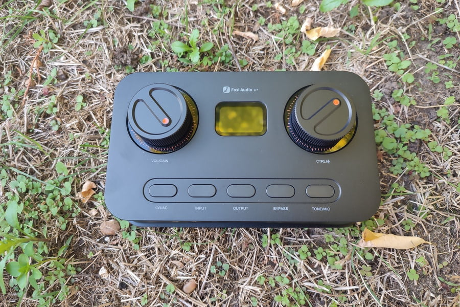

The industrial design is clean and functional, with softly rounded edges and a finish that feels closer to midrange gear than budget desktop audio. The standout feature is the angled front faceplate, which makes quick volume and setting adjustments genuinely easy—especially useful for gaming setups where the unit sits flat on a desk. The volume knobs themselves are excellent, with smooth rotation and clearly defined tactile feedback when pressed.
A 1.5-inch LCD display is mounted on the top panel. It’s basic, but that’s the point. Bright enough, easily legible from across a desk, and focused on showing the information that actually matters without visual clutter. For a compact DAC/amp at this price, it does the job cleanly and without fuss.

Up front, the K7 offers three jacks aimed squarely at headphone users: balanced 4.4mm and single-ended 3.5mm headphone outputs, along with a dedicated microphone input. Around back, connectivity is equally comprehensive, including a Bluetooth antenna, RCA outputs, coaxial and optical digital inputs, a USB-C input, and a 12V DC power input. In practical terms, Fosi Audio has made it easy to integrate the K7 into almost any desktop or small-room audio setup without workarounds.
