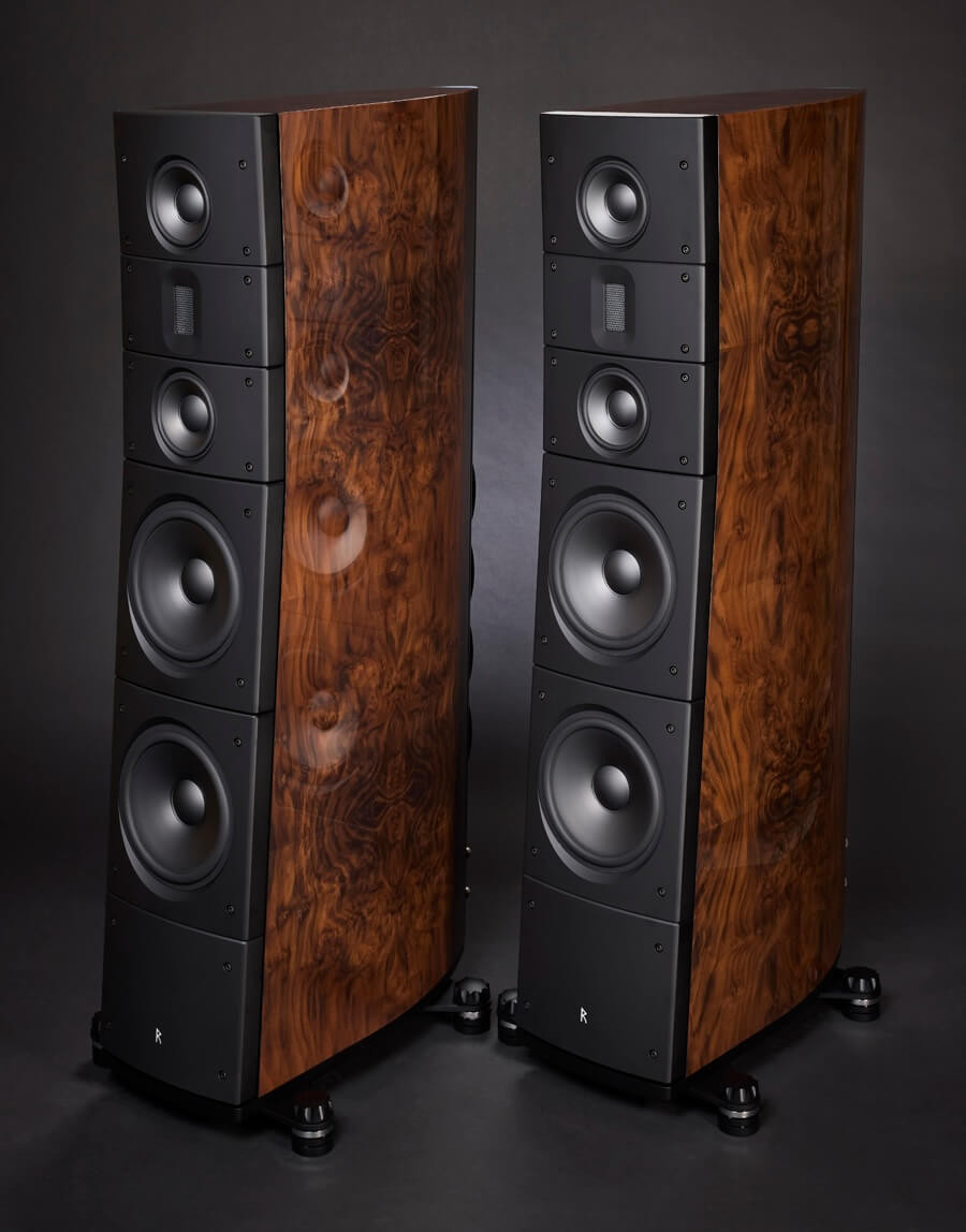

Raidho TD3.10: Because Danish Royalty Doesn’t Listen to Budget Speakers
The Raidho TD3.10 isn’t just expensive—it’s Danish-engineered arrogance carved into a 120,000-euro monolith. Born from two decades of sonic obsession, it takes everything Raidho’s ever learned—ribbon tweeters that weigh less than a politician’s promise, diamond-coated tantalum drivers that could moonlight as NASA tech—and crams it into a cabinet that looks like it could survive Ragnarok.
Twin 10-inch woofers handle the low end with such absurd control it feels like gravity takes orders from them, while the planar ribbon tweeter floats above the mix with icy Scandinavian precision. And of course, there’s the all-new reference crossover, tuned like a Stradivarius and probably more expensive than one.
The Raidho TD3.10 doesn’t care about your opinions or your wallet. It’s Denmark reminding the world that when it comes to high-end loudspeakers, they’re still writing the rules—quietly, confidently, and with a smirk.

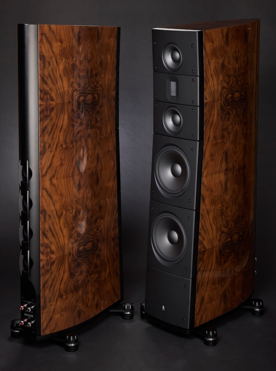

The Raidho TD3.10 doesn’t just nod politely at low frequencies—it grabs them by the throat and drags them down to 20Hz (–3 dB), all while keeping the rest of the spectrum in military-grade formation. Built off the bones of the excellent TD3.8, this new beast swaps out the 8-inch woofers for a pair of 10-inch diamond-like carbon (DLC) coated monsters—the largest of their kind in any production loudspeaker, because of course they are.
raidho-acoustics-td310-loudspeakers-front-back
Each cone is a science experiment gone right: a diamond-coated sandwich with the rigidity of titanium and the weight of a well-aimed insult. The custom low-mass voice coil rides a titanium former wound with ultra-fine litz copper, which translates to lightning-fast transients and microscopic control over complex bass passages. From 20Hz to 250Hz, this thing doesn’t just play bass—it micromanages it. It’s like handing your bottom end to a Danish engineer with OCD and unlimited funding.

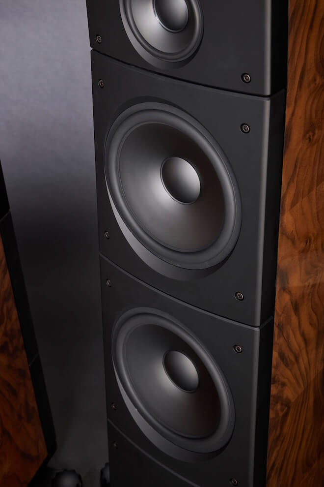

Drivers So Advanced They Might Qualify for a Nobel
Raidho’s TD-series drivers aren’t just built—they’re engineered like alien tech reverse-engineered in a Danish lab after hours. Each cone is a six-layer composite sandwich that reads like a materials science fever dream: aluminum, ceramic, tantalum, and finally, a vapor-deposited 10μm layer of 1.5-carat diamond. That diamond-like carbon (DLC) coating isn’t just for showing off—it cranks stiffness up by a factor of 50 compared to ceramic alone, while chopping resonances down by 36 dB. The result? A breakup mode pushed all the way to 20 kHz for the midrange driver, which means the transients hit fast, clean, and without a trace of sonic drama.
raidho-acoustics-td310-woofers
Under the hood, the motor system gets even crazier. We’re talking N52-grade neodymium magnets in an underhung configuration, paired with a square-wire titanium voice coil that practically vaporizes air gaps. The whole thing sits in a turbine-shaped magnet/basket combo that swats down internal reflections like a fly in a Danish bakery. Add in a magnetic flux stabilization ring to keep the impedance ruler-flat and a suspension so soft it makes a hammock jealous, and you’ve got a driver that plays nice with Raidho’s legendary ribbon tweeter across the entire frequency battlefield.

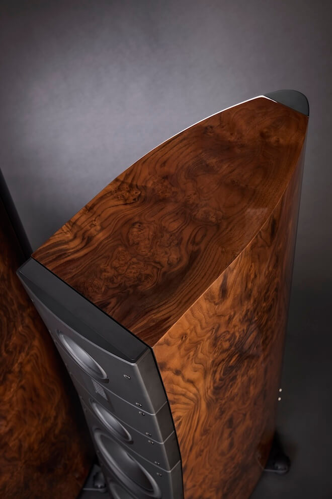

Walnut Burl Cabinets: Because Looks Matter (A Lot)
These aren’t just speakers; they’re sculptural masterpieces. Each TD3.10 cabinet begins with a rare natural walnut burl veneer, hand-selected for those hypnotic “flower” patterns that scream exclusivity. The cabinets are CNC-milled inside and out into elegant curves that aren’t just for show—they optimize resonance control and acoustic flow like a finely tuned Danish yacht hull.
Every surface goes through eight stages of precision sanding and then sixteen layers of high-gloss lacquer, creating a mirror finish so flawless it could double as a Scandinavian ice rink. Each veneer panel carries a unique serial number, making sure your left and right speakers are perfectly matched and as exclusive as a Viking longhouse guest list.
