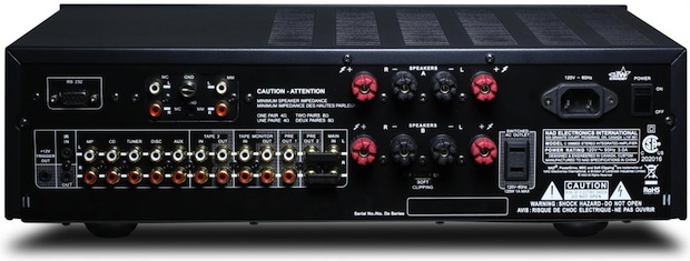

NAD C 356BEE Stereo Integrated Amplifier - Back
Other high value features include Preamp Out; new improved speaker binding posts; sonically transparent sealed reed relay switches for all inputs; front panel mini-jack for iPod or MP3 player; tone controls for any necessary correction of music without adding colouration or distortion; and a remote control compatible with other select NAD products for complete system control.
