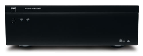

The C 275BEE Stereo Power Amplifier
The C 275BEE delivers 150 Watts to each of two channels at 4 and 8 ohms continuous power, and 250, 410 and 600W IHF dynamic power at 8, 4 and 2 Ohms, respectively. The power can be heightened to 400W to two channels by bridging the C 275BEE with a second C 275BEE into a ‘dual mono’ pair in which each channel and speaker is totally isolated from the effect of the other.
NAD C 275BEE
The C 275BEE also boasts many of the refinements found in NAD’s highly acclaimed NAD Masters Series M3 Amplifier, including an application in the output stage of Bjorn Erik Edvardsen’s innovative and patented Distortion Canceling Circuit, and his BEE Clamp in the power supply. An improved tone control circuit and revised PCB layout reduce distortion and noise to unprecedented levels. NAD’s ATO Logic circuit, which includes a 12V-trigger system and signal-sensing turn-ON option, makes it easy to integrate the
C 275BEE into automated control systems.
NAD’s PowerDrive™ technology allows the C 275BEE to deliver maximum performance under virtually any circumstance, and with any speakers. PowerDrive automatically senses a speaker’s impedance characteristics and adjusts its power settings for the specific load. It deals easily with difficult speaker loads, providing high dynamic power and low impedance drive capability in an affordable package.
The C 275BEE has the lowest levels of distortion and noise in its price class, making its performance comparable to far costlier products. Noise and distortion mask the fine details of recordings, replacing musical texture and dimension with non-musical artifacts — which is why NAD has spent 35 years perfecting its designs to achieve the lowest distortion and highest power at their price levels.
Both the C 165BEE and the C 275BEE are also environmentally responsible, manufactured according to stringent international standards, without the heavy metals identified as environmentally hazardous, and drawing less than 1 Watt in standby power.
The C 165BEE Stereo Preamplifier and C 275BEE Stereo Power Amplifier are available now for suggested prices of $899 (U.S. MSRP) and $1,199 (U.S. MSRP), respectively.
