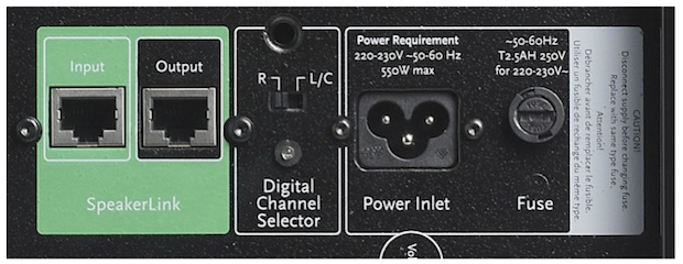

The DSP3300 is driven via Meridian SpeakerLink, which provides balanced digital audio and control signals from the host Meridian controller or source. Both input and output are provided, enabling loudspeakers to be “daisy-chained” if this is more practical than the preferred “home run” arrangement. A selector switch allows each DSP3300 to be set up as Left/Center or Right speaker in a system.

Meridian DSP3300 Digital Active Center Loudspeaker - Back
The DSP is followed by individual digital-to-analog conversion stages with extremely high precision analogue and digital design, delivering maximum dynamic range and overall audio quality. The analogue signal is then passed to powerful, highly linear, low output-impedance power amplifiers. These feature exceptional performance including low noise, low distortion, and high quality components, and are coupled directly to the drivers.

  • Meridian SpeakerLink in and out (RJ45)
  • Left/Center, Right selector switch
