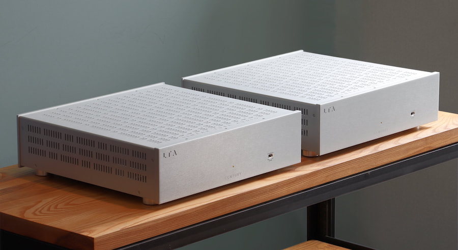

Just over the D.C. line, Linear Tube Audio handbuilds its gear, and for its tenth anniversary, it’s unveiling the Century Monoblocks: high-powered ZOTL (Zero-Hysteresis Output Transformerless) amplifiers developed with David Berning. Priced at $28,000 per stereo pair, the Century Monoblocks ship first in brushed Quicksilver this November, with Carbon Black later this year. LTA, already known for some of the best headphone amplifiers on the planet, now brings that craftsmanship to a flagship monoblock design.
The Century Monoblocks mark a decade of innovation, inspired by the endurance of the century ride—a 100-mile cycling milestone—and aimed at audiophiles who demand both power and finesse. Combining LTA’s latest advancements with ZOTL architecture, the Century Monoblocks deliver performance capable of driving demanding speakers, including electrostatics, planars, and low-sensitivity designs.

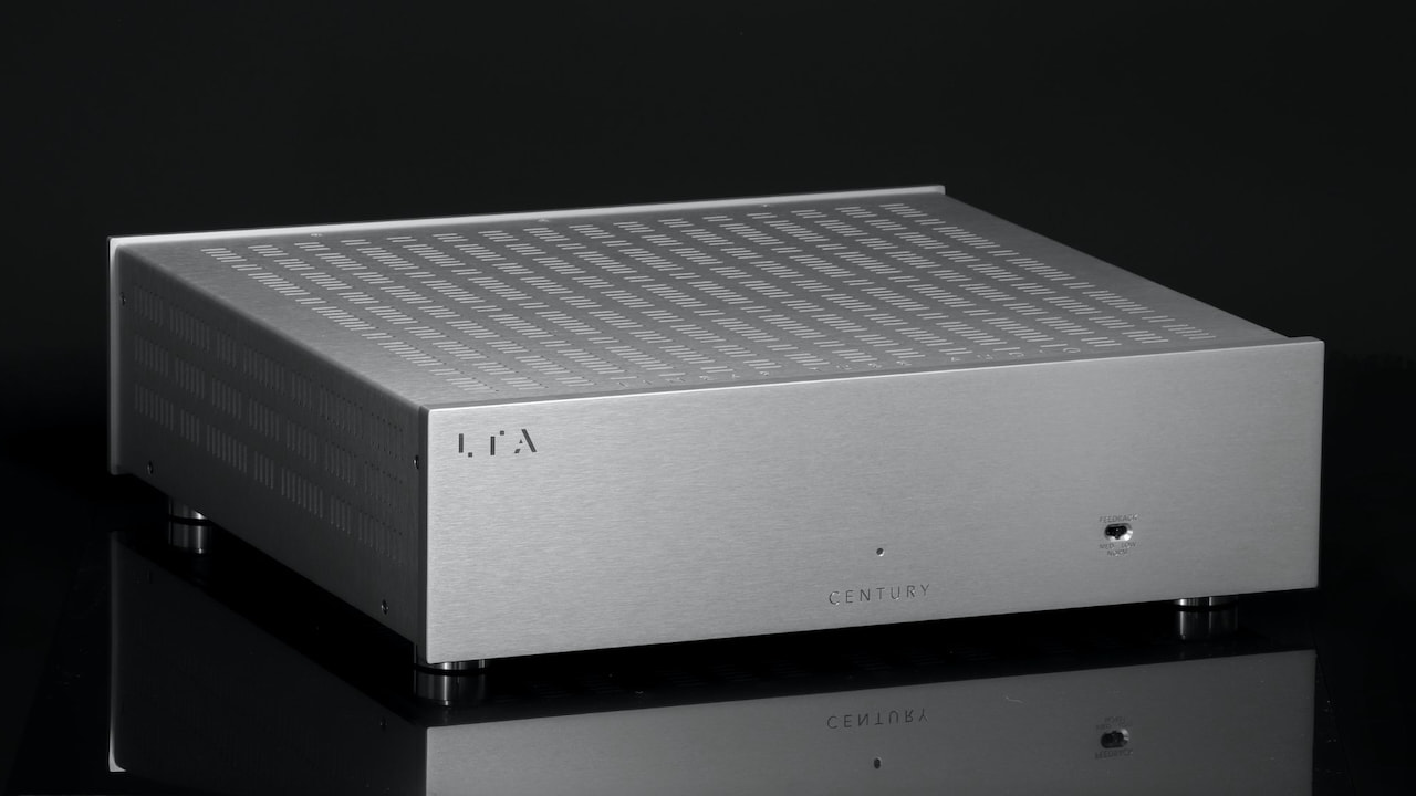

For the first time in LTA’s lineup, the Century Monoblocks use a screen-driven output stage within the ZOTL architecture. EL84 pentodes control the screen grids of NOS 6JN6 beam power tubes, combining the efficiency of pentode operation with the linearity and smoothness of triodes. The result is detailed, fast, and uncolored sound with remarkable depth.
Traditional tube amps can struggle with complex or capacitive speaker loads, causing frequency shifts and reduced control. The Century Monoblocks address these issues with a low output impedance and wide bandwidth. Their transformerless design removes hysteresis, phase shifts, and the frequency-dependent distortions common in transformer-coupled amplifiers. The outcome is the speed and grip of solid-state electronics, paired with the dimensionality and holographic soundstage of a great tube amp—effortless authority even with demanding crossovers or full-range panels.

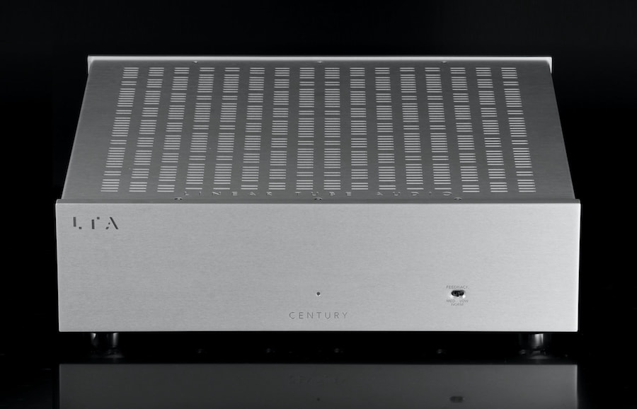

Each Century Monoblock is hand-built in Maryland with carefully selected components aimed at accuracy and musicality. Non-magnetic resistors, ferrite-core impedance converters, and a minimalist signal path work together to provide a precise and uncolored presentation. Voicing is finalized through extensive listening, and the non-magnetic aluminum chassis with full Faraday shielding ensures effective noise rejection.
Building on Berning’s Quadrature Z heritage, the Century Monoblocks offer low noise, improved stability, and practical features for today’s listener. These include auto-biasing, global voltage compatibility (100–260 VAC), built-in protection circuits, adjustable global feedback, and tubes designed to run cool for long-term reliability. Their transformerless design also keeps the amplifiers relatively light.

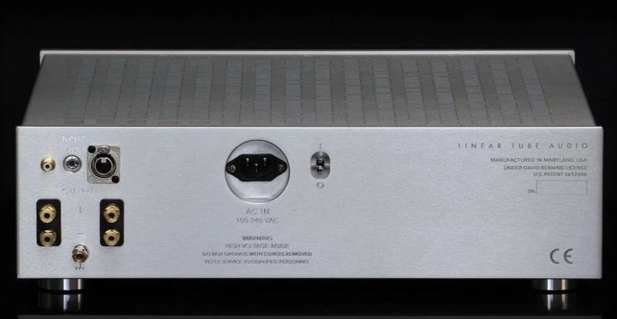

Outputs support dual binding posts for bi-wiring, and there is a rear-panel GND post. Modern conveniences include auto-biasing, automatic voltage selection, and built-in protection circuits, with low heat output and a 3400 V peak-to-peak power tube swing supported by approximately 1 Farad of storage capacitance.
Frequency response varies with load and feedback: at 8 Ω it spans from 1.3 Hz to 44 kHz (LOW), 1.14 Hz to 64 kHz (MED), and 1.3 Hz to 90 kHz (NORM); at 4 Ω, 1.23 Hz to 37 kHz (LOW), 1.17 Hz to 46 kHz (MED), and 1.3 Hz to 58 kHz (NORM). Input impedance for RCA ranges from 20k to 47k Ω and XLR from 28k to 94k Ω depending on feedback.
Output impedance ranges from 0.8 Ω (NORM) to 5.2 Ω (LOW). Each amplifier weighs 26.5 lbs (12 kg) and operates across 100–260 VAC, 50–60 Hz with power factor correction.
