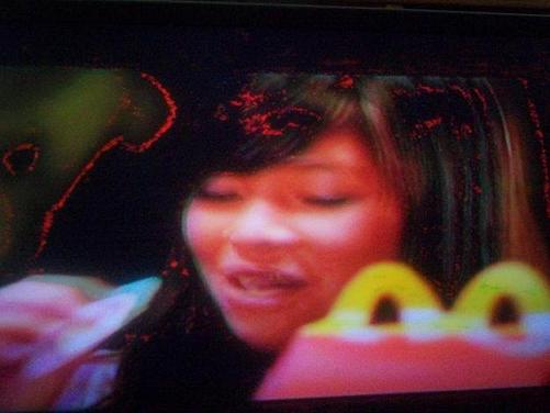

Gene, I am having a similar issue with my HLP5063W, except instead of having red pixels appear, my set is producing green pixels immediately after turning on the set. It started out initially on edges of objects and in green areas (sports) but has now overtaken much of the screen making it an un-enjoyable experience. From what I gather on this site its either the DMD board or the light engine that is starting to go. Have you found a solution? Does anyone have any suggestions as to how to diagnose the issue myself or is it worth paying the extra money to have someone in to repair it?
also the set was bought new almost exactly 2 years ago without an extended warranty (my own fault)

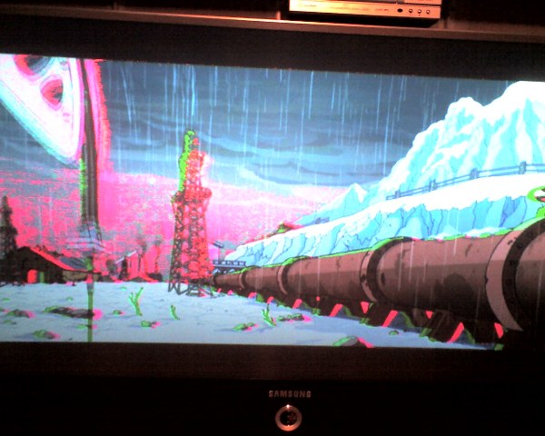

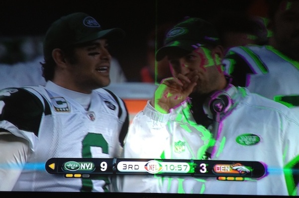

Username: Wolfganggullich
Seaside, CA
So, for all you HL-R series owners...
I wonder how many of you that are having the color bleed over/solariztion problem have Dish Network boxes hooked up to your tvs?
I had a huge problem with my now 3 yr old HL-R5067W where upon displaying any HD programming, the TV would go into a weird solarizing/bleed over glitch.
This problem would even carry over onto regular broadcast channels, when I played DVDs and my Wii.
We had thought that either the digital board or the input section was dying as this problem replicated the exact same symptoms.
We recently moved to MD and have a Comcast HD box as well as a BluRay now and our tv no longer displys this problem. I know it didn't fix itself and this has been the only change to our setup.

Hi Guys,
I have a Samsung HL-R6768WX/XAA DLP TV. I got the infamous Grey Bar. I called Samsung and they said that they would send a service tech to my house. If it is the light tunnel then they'll change it out free of charge, but if its not the light tunnel, I have to pay for the guy coming out.
This is what it looks like, can you confirm that this is the light tunnel issue?

samsung hlp5063w DLP 50"
Has red highlights around everything. Bad bulb?
Username: Madman1973
Registered: May-10
this is what it looks likeUpload
Username: Potentialjvcowner
Post Number: 105
Tony, probably not a bulb. Could just be severely misadjusted picture controls.

My Samsung HLT6187SAX/XAA lost the red last week. I just replaced the red led and still no red . Any ideas please
