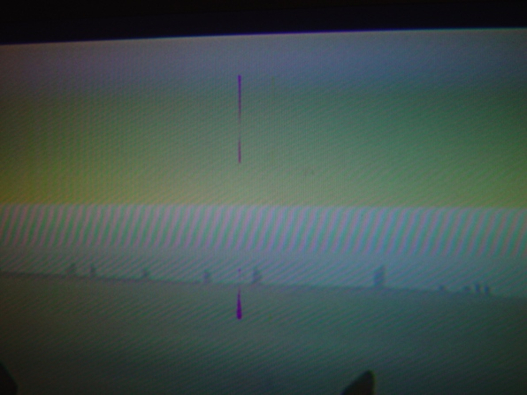

Username: Irishgal
I need advice please!
Bought a fabulous Samsung HLR5067 50"DLP about a year and a half ago. It was a huge splurge at $2,200. I really hate to admit it, but I love it. It is just beautiful, but recently all the channels turned green, other than the HD channels. I can only watch HD channels now.
My local Samsung tech (great guy, really) sadly told me that I need a new digital board to the tune of almost $700. The part alone is $460.
From the posts above I can see that the digital boards for some of the Samsung models continually have problems.
Samsung has agreed to look over my info. (original receipt and tech's diagnosis), but has made no promises. I am barely out of warranty. I will hear from them in 3-5 days.
Does anyone (FYI?) think my model is a lemon(digital board-wise)? If Samsung does not help me with repair, is my money better spent buying a less troublesome and less expensive brand and model rather than repair? Like everyone else here, I do not have $700 extra to repair a digital board every couple of years and just need some guidance.
Any insight is very much appreciated. Thanks!

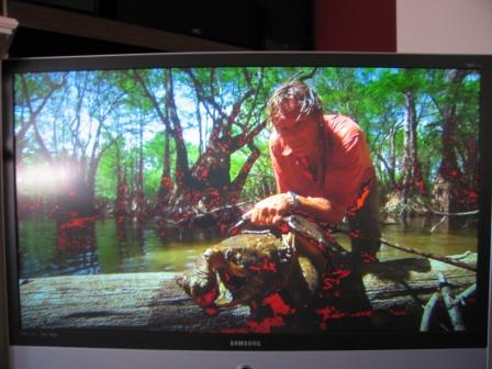

Username: Schafari
Great forum. I have a problem with my Samsung DLP HLP5063W. The picture now shows psychedelic red splotches on the screen. It is red wierd pixcels that are especially in spots where there are dark colors. It doesn't really effect light colors. It is on all inputs. It is on the screen even on sources that have no inputs. I am the original owner.
FYI, please help. What does this sound like?

Well Katherine,
I predict Samsung will extend your warranty for 90 days and replace your board. When you mass produce electronics there will be some run errors. Most likely, everything will be fine with the new one.
D,
That's a new one!
Samsung R & D may be very interested in knowing what that is too. Call'em up and plead your case. Get past the first SR's. Be polite, but firm. Persistent is often rewarded.

Username: Schafari
My color problem on my HLP5063W continues. In fact, now I am also getting light green spots on flesh colored peoples faces. The red splotches still is on almost all areas that are shadows and dark. I tried to take a picture and have attached it. Please help. Upload
Username: Schafari
The color problem I am having also effects the actual TV menu, and screen with no inputs or outputs attached. Even switching to an input that is supposed to be a black background gives a red freaky backgournd. The menus for the TV have a red tint and pixelatted.
The other odd thing, is that if I adjust the color weakness setting for red or green, it visibily changes the picture. However, if I change the blue slider, I really can't see any difference at all.
In an attempt to solve, I have removed the lower back cover and see nothing odd. I carefully vaccummed all dust, etc. When I did this, the TV was unplugged of course. When I plugged it back in, the TV was fine. . .for about five hours. . .now it is back to the funky colors again.
The TV is mint, and i am the original owner. It was one of the of very first "P" series as I was on a long waiting list at a local HiFi store.
Username: Schafari
Ok, I called Samsung and am going to get the TV diagnosed. Agent was very nice and helpful. Asked for original receipt which I am faxing.
FYI, I think the prompts have changed to 4, 1, 1, 1.

Username: Raoule
Registered: Apr-07
Hello
I've got an HCN4226W with a purple streak down the middle of the screen. It's only about 1/4 of an inch wide and it doesn't vary. It actually isn't a big deal, mostly a nuisance. Still, I would like to fix it if I can. I'm attaching an image - apologies for the quality. Any help will be appreciated.Upload

As of about close to 2 mos ago, it started having a weird color ghosting problem. It does this on HD and video games (have a Nintendo Wii that runs 480p), but not on regular cable channels (well, DishNetwork satellite) or DVDs.
The DVD and Satellite run through component video and the Wii runs through a normal yellow video cable, but I don't see how the input would matter as technically, the HD and reg res channels are coming into the TV on the same component cable.
Today, I opened her up and dusted out the lamp area and around the color wheel and then went into the service menu and reset the color. And within 10 minutes, it started it's games again.
The colors that are affected are bright bluey whites, blues, reds and occasionally greens. Please tell me my tv doesn't need a new engine. I plan on changing the lamp but I know that's not the problem. Could this be the DMD board problem rearing it's ugly head?

Fred,
I had the exact same problem with the exact same TV and it turned out to be the digital board. The service manual pointed to the DMD board but replacing it did not correct the problem. After putting the original DMD back in and replacing the digital board, all was well. Sears parts has the best prices for parts that I could find.
