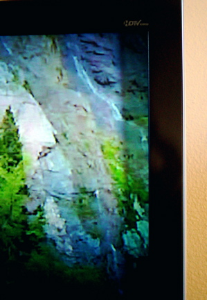

New member Username: PatrickwPost Number: 1 Registered: Jan-07 | Same side banding problem on my HL-R6168W. Mine is on the right side of the TV. Started after about 16 months of use. I will call Samsung this week and let the board know what they said. This is a BIG customer service option. IMHO. The need to fix this and offer a repair service..this is clearly a default of the unit. |
Silver Member Username: FyiDallas, Texas Post Number: 999 Registered: May-05 | Banding is usually caused by compressed mpeg2 source material. Does it happen on HD channels? Other inputs too? Sat compressed standard def is the worst. |
New member Username: PatrickwPost Number: 2 Registered: Jan-07 | FYI--No my problem is the same as Cliff's in the first post. except my "shaded" band is on the right side of the tv. Same tapered shape too. |
