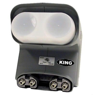

Platinum Member Username: LklivesPost Number: 11663 Registered: Jan-06 | Dish pro (DP) switches are ONLY for Dish Pro LNB's....not all Dish 500's have Twin Dish Pro (DP) LNB's ....some have 2 dual Legacy LNB's...so what switches U use is determined by the LNB's.. A simple DP Quad LNB (buy for $79 at sadoun.com) on 1 Dish (no need for 2 dishes, disconnect one), receives BOTH the 110 and 119 (or 82-91 sats)...and runs DIRECT lines to 4 receivers....NO SWITCHES are used! Dish Network Dish Pro Quad LNBF: Use it to look at the 110 and 119 orbital locations, using a 20" (or "DISH 500") dish antenna. The DishPro Quad LNBF can directly connect to Four tuner inputs (either Four "single tuner receivers" like Dish311, or Two "two tuner receiver" like DishPVR 625). Circular type....or can use with FTA receivers...$79 http://www.sadoun.com/Sat/Order/LNBFS/DISHNETWORK-LNBF.htm or U can buy (www.sadoun.com)for $99 the Dish 500 WITH the DP Quad LNB...makes MUCH more sense to spend $20 more and get the Dish 500 AND the DP Quad LNB already mounted and ready to put on the roof..then U will have 2 extra Dish 500's, presuming U already have them http://www.sadoun.com/Sat/Order/Dishes/Dish-Network-Satellite-Dish.htm#Dish_Netw ork_DISH_500 Dish Network DISH 500 Antenna with LNBF Box Includes: 20" Satellite Dish 500 Universal mount that lets you put the dish on your roof or exterior wall of your house Available with Dish Pro Quad Lnbf (for 110, 119), ...get this one!..... or with Dish Pro Plus Twin LNBF (for 110, 119)....suggest NOT to get this Dish Pro Plus TWIN Only $99 |
