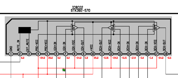

New member Username: VolverinePost Number: 1 Registered: Aug-06 | Where can I buy original Mitsubishi IC STK392-570? |

New member Username: VolverinePost Number: 2 Registered: Aug-06 | I couldn't find STK392-570 on mitsubishi site. So I ordered them from electronix.com BTW How do I remove these connectors between PCBs? They seem to be hard to move. From which side do I remove them? Deep groove side or flat side? Also, how do I put them back in these tiny slots? Any tricks? Techniques? |

New member Username: VolverinePost Number: 3 Registered: Aug-06 | Finally I received my ICs on friday and here is the update on what I did. 1. I opened up the back cover. Then took out black plastic cover on top of all input/output connectors. 2. Took out front speaker grill and another panel. I kept a note of location of screws. 3. In order to remove middle PCB, I had to - -- remove three screws (from back side of TV) -- remove two screws (from front side of TV) These screws hold the PCB down on plastic tray. 4. I had a question about those white connectors which connect to other PCBs. There are three on one side and two on other. I used a big flat head screwdriver to remove them. They remove from side where you see shiny flat wires not from grooves with wires in it. I put the head of screwdriver in an angle at the side of jumper, resting one side on PCB and twisted it slowly and it popped open. 5. Now heat sink screws. They can be explained simply as "pain in @ss". The ICs are sandwiched between heatsink and another piece of metal. They are held together by three screws. I removed them first and then removed the metal strip. Then removed the three screws from heatsink which hold heatsink and PCB together. Without removing these screws the PCB won't move. 6. There are 5 connectors on front and 1 connector on back. I removed them making note of which one goes where. 7. Finally I removed PCB from TV. Removed ICs and replaced them with new ones. Then used new heat transfer paste and put everything back together and TV doesn't have convergence problem anymore. Times when I said "S***!!" ========================== 1. While removing both ICs, I use desoldering gun to remove most of the solder. But as mentioned in previous posts, the PCB copper layout is very fragile. You will defintely remove the copper layout. One IC removal damaged copper layout of 4 pins. For removing other IC, I followed one of the advises to cut off the pins. This is definitely recommended process unless you have some high-tech temparature maintained soldering gun. While removing first IC, I used a tool which accidently scratched across back side of PCB but fortunately it wasn't deep and nothing was damaged. I should have been more careful about it. Before mounting ICs, I used a razor to expose more copper around damaged pins. After mounting ICs, I bent the pins so that the pins touch exposed copper. I maintained alternate pin soldering between ICs and mounted both of them. (If it would not have worked, I was thinking to buy teflon wires and connect them directly from pin to next component.) This PCB doesn't look like multi-layered so they could have made it more robust. 2. After mounting heat sink, front connectors, metal strip on heat sink, connector in back, three jumpers to one side of PCB, I figured out one of the jumpers on other side is under middle PCB. There is no way to get it out unless you remove entire assembly. I had to remove everything again just to get this jumper from underside of PCB. 3. While putting PCB connectors, I noticed that one of the wire popped out. I used small screwdriver to push it back in. Info: ===== Model: WS-55809 Problem: Convergence IC: STK392-570 Source: electronix.com Tools: All sorts of screwdrivers (Small ones especially useful), soldering gun, desoldering gun, flux, pliers ... Paid: $28 (2 ICs, heat transfer paste + Shipping) Time taken: 9pm - 4am (7 hours!!!) That's all. Finally Cartoon Network can be watched again !!! |

New member Username: GavincurtisPost Number: 2 Registered: Aug-06 | You can also purchase the STK392-570 on ebay for about 10 dollars each from multiple sources. It's a no brainer to replace both or at least keep a second set on hand at that price. The originals will ultimately fail in the useable lifetime of the TV; with the existing heatsink cooling capacity. I figured they would be much more expensive! |
