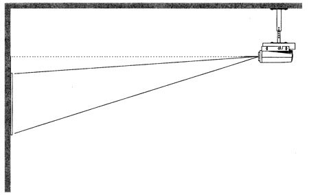

A projector’s image doesn’t follow the lens precisely, like a flashlight. The image is offset a bit to accommodate placement on a table or ceiling mounting. This means that the image is raised somewhat for table placement (see above), and similarly lowered for ceiling mounting (see below). For ceiling mounting, you’ll also turn the projector upside-down.}
Projector Placement on the ceiling

As you compare projector features and performance, it’s also a good idea to keep a few installation issues in mind. First, you’ll want to have at least a rough idea of how large an image you want to project, because that will affect the distance between the projector and your screen. With any projector, the further you position it from your screen, the bigger the image will be. But different projectors have different “throw ratios.” The throw ratio is the relationship between a projector’s distance from the screen and the width of the image. A projector with a “short-throw” lens projects a larger image for a given distance from the screen, so it’s a smart choice for smaller rooms where the projector is placed relatively close to the screen. Long-throw projectors are good for ceiling-mount situations where the projector will be placed further back in the room, behind the viewing position.
If your projector will be ceiling-mounted, it’s important to make sure the lens is parallel to the screen. That helps ensure that your image will be true, with straight edges on all sides. If a projector isn’t correctly aligned in relation to the screen, the image will look like a trapezoid instead of a rectangle — the top of the image will be wider than the bottom, or the left side will be taller than the right side, for example.
Fortunately, there are two ways to fix picture shape: lens shift and keystone correction. Lens shift lets you tweak the position of the lens inside the projector, so you can compensate for your projector being slightly off-axis. Keystone correction, on the other hand, adjusts the image’s shape using internal processing that can slightly degrade the quality of the image. Nearly all projectors offer keystone correction, but only some offer lens shift. So if you’d like a little installation flexibility, especially if you plan on ceiling-mounting your projector, consider a model that offers lens shift so you can adjust the shape of the image without affecting its quality.
