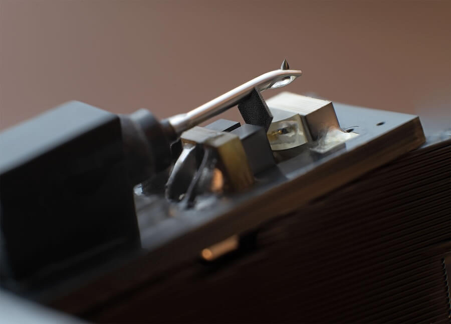

What makes the Waiting for Ideas PP-1 (yes, “Plug and Play 1”) stand out is its blatant disregard for the standard tonearm. No tonearm to fiddle with, no adjustments to make—just flip the vinyl upside down, hit Play, and let the 0.4 x 0.7 mil elliptical diamond stylus take care of business.
The folks at Waiting for Ideas aren’t big on sharing every detail, like whether it uses an MM or MC cartridge (probably a secret they’re saving for a French wine pairing), but the stylus is flipped upside down to do the hard work of reading those grooves. It’s minimalist to the point of being almost reckless, but hey, sometimes simple is better, right?

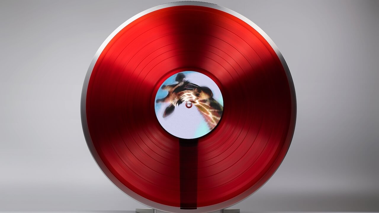

And now the Dutch are back at it with the Miniot Wheel 3. This one plays your records from below—because of course it does—and hides all the tech underneath like it’s too good to show off. It’ll sit on your credenza or hang on your wall like some audiophile art installation, quietly judging your IKEA media unit. Bold? Definitely. Useful? We’ll see. But one thing’s for sure: leave it to the Dutch to make playing a record feel like operating a spacecraft.
In 2022, Miniot set out to build the ultimate Wheel turntable. The result is Wheel 3 – the culmination of that vision. More than just the finest Wheel ever made, it’s the definitive record player.

  • Revolutionary Optical Pickup System: Wheel 3 uses a diamond stylus without magnets or coils. Vibrations from the stylus are optically converted into an analog audio signal, along with a position signal. Its inverted design places the sensor close to the stylus tip, allowing for accurate tracking.

  • Direct Drive Motor: The Wheel 3 incorporates an axial flux direct-drive motor that was designed and built in-house. Motor speed is optically controlled.
  • Rigid Linear Tonearm: The linear tonearm on the Wheel 3 has been redesigned with a focus on precision and quiet operation. It moves vertically from bottom to top, contributing to the symmetrical layout and helping to reduce dust exposure.
  • Flexible Installation: According to Miniot, the Wheel 3 can be used upright on its stand, on a flat surface, or hung on the wall. The new mechanism works at any angle, even upside down.

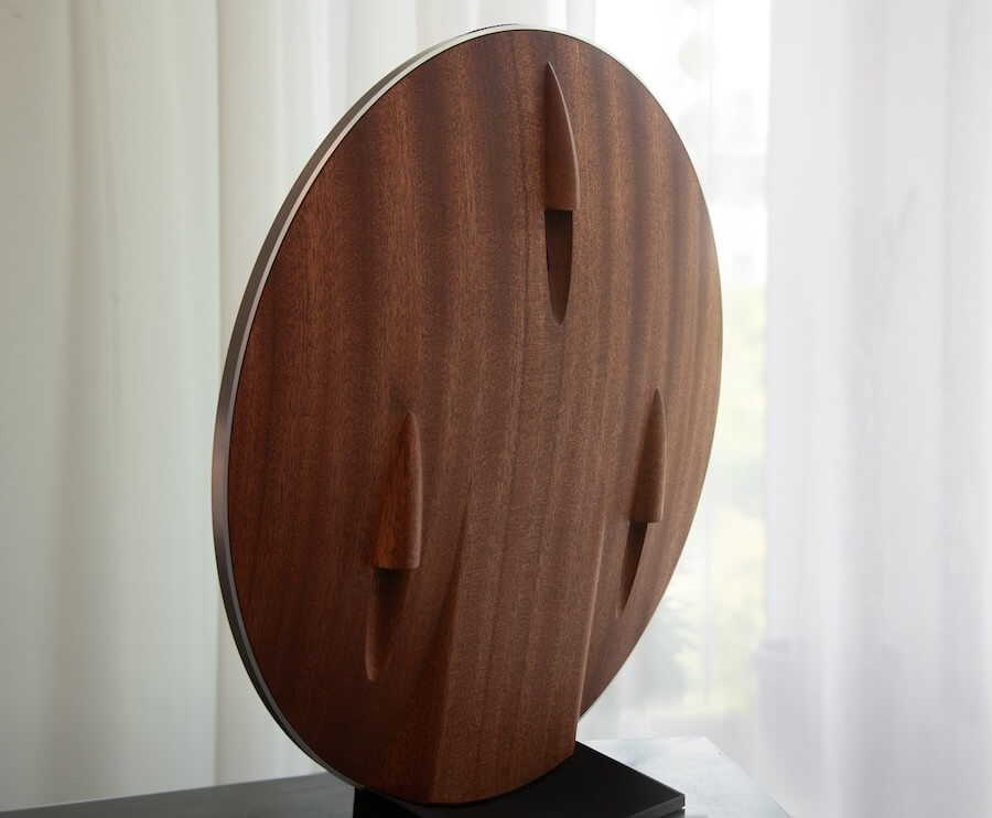

A Special Edition is also forthcoming (no date has been announced) that will feature solid wooden back, as shown below.
