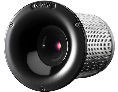

Lansche Audio Corona Plasma Tweeter
The Corona Plasma Tweeter, a hallmark of Lansche technology, comes closer than any other tweeter to the ideal of a point-shaped sound source with zero mass, since it employs an 8mm-long electric arc to directly activate the surrounding air as a sound transmission medium. The tweeter’s arc of resonance-free, voltage-modulated air helps it avoid the limitations of conventional tweeters to achieve outstanding impulse, phase and amplitude response, and an exact, three-dimensional sound. As a result, the No. 5.1 delivers faithful, coherent musical reproduction with incredible precision, speed and economy.
