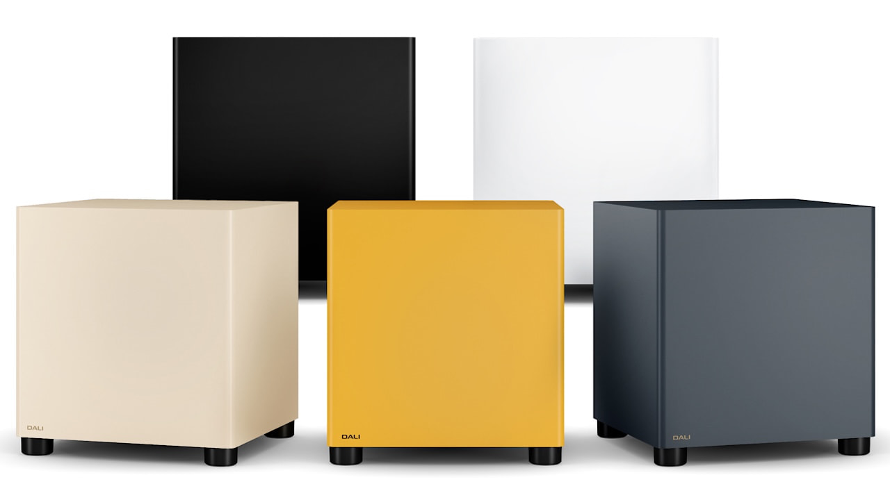

Small loudspeakers have become considerably better at delivering convincing bass, but physics remains undefeated. DALI thinks the answer does not have to involve adding a large black box to the corner of the room.
The Danish loudspeaker manufacturer has introduced the DALI BASIK SUB, a compact active subwoofer designed to add greater low-frequency extension, scale, and impact to smaller music and home theater systems. Developed as a natural partner for compact bookshelf loudspeakers including the DALI KUPID and SONIK 1, the BASIK SUB combines an in-house designed 8-inch down-firing long-stroke woofer with Class D amplification, flexible system integration, and five finish options.

Compact Cabinet With Five Finish Options
The BASIK SUB uses a compact MDF enclosure available in Solid Black, Solid White, Caramel White, Golden Yellow, and Chilly Blue, allowing it to coordinate visually with DALI’s KUPID and SONIK compact loudspeakers.
