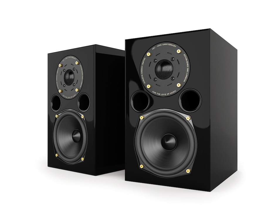

Four decades later, the £1499 Acoustic Energy AE1 40th Anniversary Edition brings that design forward. With all original parts long out of production, the speaker has been fully re-engineered to match the sonic DNA of the classic while refining a few key areas.
The tweeter is a completely new design, built specifically to mirror the performance of the original unit. It now carries a larger 29mm voice coil and slightly larger aluminium dome, improving radiating area and lowering distortion. The ultra-shallow profile maintains bandwidth, while a new rear chamber controls resonance and absorbs unwanted energy. Like the first AE1, it uses ferrofluid cooling for better power handling, lower thermal compression, and stable dynamics.
The woofer has also been redeveloped. Using modern 125mm standards, its slightly larger cone provides greater efficiency and air movement. The design retains the straight-sided aluminium profile and spinning process that defined the original, with added strength from a hard-anodised ceramic layer on both sides of the cone.
ae1-40th-anniversary-walnut-no-grille-angle
The thermally conductive aluminium voice coil sits inside a powerful motor structure, now improved with an aluminium shorting ring to reduce distortion from inductance variations. The driver has been specified at 5 ohms DCR rather than the original 7 ohms, making it easier to drive with a wider range of amplifiers.
The crossover draws from the work done on the AE1 Signature, using low-order filters and high-grade components for a natural, dynamic sound. Voicing has been adapted for domestic listening rather than strict studio use, with a balanced midrange, weightier low end, and smoother treble response.
The cabinet remains compact but benefits from Acoustic Energy’s RSC material to increase stiffness and replicate the tonal character of the original concrete-lined enclosures. It is available in high-gloss black or walnut veneer, finished with ten layers of lacquer. Ports have been re-tooled with an internal flare to cut distortion and extend bass performance.
The result is a loudspeaker that carries forward the essential AE1 formula—metal dome tweeter, stiff spun-aluminium midbass, heavy cabinet, and twin front ports—while updating every component for modern production and reliability.
The AE1 40th sticks with the trusted 2-way format, pairing a new 29mm anodised aluminium dome tweeter with a 125mm spun and hard-anodised aluminium mid/bass cone. Together, they deliver a frequency range from 50Hz up to 45kHz, which is far beyond human hearing but keeps harmonics clean and intact.
Sensitivity is rated at 87dB, meaning they’ll like a bit of power behind them—though the redesigned 6-ohm impedance and 150W handling make them far easier to partner with modern amps compared to the original AE1’s appetite for juice. The crossover sits at 2.8kHz, a sweet spot for balancing that metal-dome top end with the fast, rigid bass driver.
ae1-40th-anniversary-walnut-with-grille
The cabinet is classic AE1: small, solid, and heavy. Built from 18–22mm RSC constrained-layer HDF with bitumen damping, it’s braced and twin reflex-ported at the front.
You get the choice of high-gloss walnut veneer or high-gloss black, both with ten coats of lacquer. At 295 x 180 x 240mm and 7kg apiece, they’re still compact but feel reassuringly substantial. Magnetic cloth grilles are included if you want to cover up that purposeful look.
