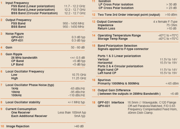

Gold Member Username: The_codersPost Number: 1669 Registered: Jan-08 | Do you understand how the QPH-031 works ? It has 4 outputs for 2 receivers , 2 are circular and 2 linear - you need a switch (and I recommend at least a cheita quality)to combine 1 linear and 1 circular output to 1 receiver then set the switch settings in your menu . As I mentioned before , the setting for the Invacom is "STANDARD". ALSO it doesn't matter what sat your pointing when using USALS |

Bronze Member Username: Viewsat_ultraPost Number: 70 Registered: Nov-07 | I do understand to a degree,I knew that the 4 outputs are for two circular and two linear.Iwas told to get rid of the DP34,so I thought I could use a DISEqC with 1 coax from circular and 1 coax from linear to the DISEqC switch then 1 coax to the motor and out to the receiver.Now I assuming that I'm incorrect.Am I incorrect? Thanks for verifying that it is indeed standard. |
