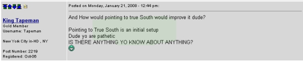

And How would pointing to true South would improve it dude?
Pointing to True South is an initial setup
Dude yo are pathetic
IS THERE ANYTHING YO KNOW ABOUT ANYTHING?
