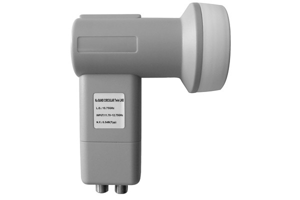

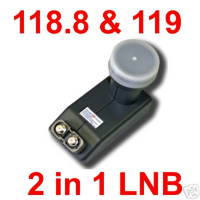

Gold Member Username: Cartier1Post Number: 2054 Registered: Feb-07 | HERE WE GO plymouth tv5 monde is moved from echo3 to 118.7 . i even called DN and they confirm it to me . when baying an lnb make sure you have the right braket or you may end up having trouble . |
Gold Member Username: Cartier1Post Number: 2055 Registered: Feb-07 | 1 for almost $30 from ebay.the second one for $15 ![]() |
