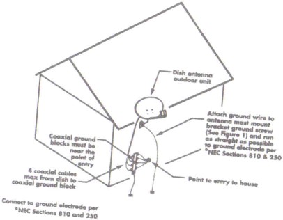

Bronze Member Username: MeishaPost Number: 45 Registered: Aug-05 | HI I purchased two ground blocks for me 3 Dual LNB that are connected to 2 receivers, and purchased a 8 feet metal rod and drove it into the ground, Can anyone tell me or post a link how to to properly ground my satilles ? Thanks |
Gold Member Username: PlymouthQuebec city, Quebec Canada Post Number: 3490 Registered: Jan-08 | Meisha you does need a 8 feet metal rod , ground it on electric mat of house or existing ground here is a link for grounding: http://www.sadoun.com/Sat/Installation/Grounding.htm |

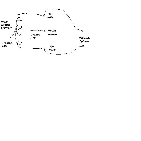

Gold Member Username: PlymouthQuebec city, Quebec Canada Post Number: 3605 Registered: Jan-08 | White 240 volts wiring is identical in USA and Canada The shematic i shown is from Electric Provider to Meter In breaker panel ground is tap on White, red and black are 2 X 120 volts taps 240 volts work on only one phase, and not phase A and B, but tap A and B 1 phase is a alternate wave 0 to +240 to 0 to -240 who give 360 degrees In 3 phases each phases is shifted with 120 degrees I hope you understand difference btw phases and Taps |

Gold Member Username: PlymouthQuebec city, Quebec Canada Post Number: 3606 Registered: Jan-08 | King Sorry you are not right, you cant create a new phase with a transfo, but a isolate tape on same phase Look it You can created a new phase only with a Rotophase or a electronic motor drive, which transform AC to DC and create 3 phase 2 phases exist only on AC motor and the second phase is created inside motor coil and capacitor use for start the motor with centrifugal switch White This is a transfo who explained how have 120 volts 1 phases from 3 phases use when 240 volts 1 phase not available, not use for private house. I hope now you, King and White understand now, how it work. ![]() |
