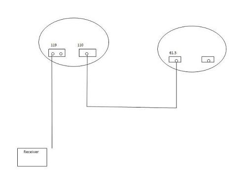

Hello All,
Guys, I have the attached configuration.I get channels from 119 and 110 but from 61.5 I get the signal(75%) but no channels. Also I noticed that if I scan 61.5 1st I get all the channels but as soon as I scan for 119 channels, all the channels of 61.5 disappear.
Anyone knows how to come over this ? Thanks in Adavance.

can't see the doc.
try to scan one sat at a time and do save it.

post your antenna settings here so we can help
Username: Jerkisland
Post Number: 88
Sorry, here is the attachment. Also my receiver is Viewsat Ultra.Upload

Are you using Dish Pro Plus LNBs?

where is the switch?

Yes I am using Dish Pro Lnb and I don't have any switch since there is no need for it.

have you ever had it working before with all three satellites?because on the dish pro lnb you have a built in switch for 119 and 110 but not for 61.5 which is on a separate dish and lnb

It did works only for about 2-3 minutes and then there is only signal on 61.5 but no quality.

my friend you need to install the switch which came with the receiver
turn receiver off and hook up 119 to port 1 110 to port 2 and 61.5 to port 3
then turn receiver on and go to antenna settings and assign port 1 to 119 port 2 to 110 and port3 to 61.5,and scan 61.5 if you need to
you will be up and running
enjoy

The Switch that came with the reciever got busted, may be I burnt the fuse. What precautions need to be taken while connecting the switch ? so that I don't burn the switch again ?

always have receiver turned off from back when hooking up or unhooking co ax cable or diseqc switch
FAILURE TO DO SO MAY RESULT I DAMAGE TO SWITCH AND OR RECEIVER
get yourself a new switch preferably a chieta heavy duty,and hook it up
