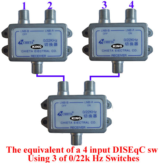

Platinum Member Username: TapemanNew York City in-HD, NY Post Number: 2651 Registered: Oct-06 | 22K switch won't work in this case I would use a 3x4 switch to split the signal 2 input in to sw 13v and 18v 4 output to 4 receivers plus 2 other inputs from dish for a total of 6 receivers if necessary This is how to turn a 2 input signal to a 4 output signal: reference: https://www.ecoustics.com/cgi-bin/bbs/show.pl?tpc=2&post=1496579#POST1496579 ![]() |

Platinum Member Username: TapemanNew York City in-HD, NY Post Number: 2652 Registered: Oct-06 | 22K is an on/off switch Mainly to be used to add an extra satellite not to expand an extra receiver The 6x8 switch is for 3 satellites Each sat requires 2 inputs for 13/18volt or for vertical and horizontal switchings 6x8 is for 3 sats, 8 receivers But my answer is an extra 3x4 switch will convert a 2 input to a 4 output I'm a 100% sure and will do the job despite if dtv recommends something else I'm not a dtv technician however it's an insult to call me a technician |

Platinum Member Username: TapemanNew York City in-HD, NY Post Number: 2653 Registered: Oct-06 | It's never to my intention to say who is right or wrong I just give my prospective and the user or reader can decide for himself there is no winner or loser exchange of information is the key for everyone to learn Yo can cascade 3 of 22k sw to make a 4 input to one output it's mainly how a DISEqC switch is made anyway but this user Dennis Gall wants to increase the # of outputs and in this situation yo would want to split the signal so the 3x4 switch I got above can do it much easier than a 22k sw |
Platinum Member Username: PlymouthQuebec city, Quebec Canada Post Number: 1545 Registered: Jan-08 | King too much switch can lose db signal, i dont think this is the best solution. What do you think? |
Silver Member Username: ExtremexPost Number: 196 Registered: Nov-07 | How would that setup ever switch to sat 2 or 3??????? |
Platinum Member Username: PlymouthQuebec city, Quebec Canada Post Number: 1553 Registered: Jan-08 | Not Today I think like you that doesnt work on 3 and 4 good remark |
Platinum Member Username: TapemanNew York City in-HD, NY Post Number: 2654 Registered: Oct-06 | "King too much switch can lose db signal, " Not too much one or two Dbs even much less if yo use good connectors and quad shield RG-6 It's how they make all the circuits for satellites the concept is the same I'm not recommending 3 of 22k switches over DISEqC I'm only saying it's the equivalent of Using a combined circuit is to cut down on too many unnecessary coax cables but will work I assure yo just as good. |
Platinum Member Username: PlymouthQuebec city, Quebec Canada Post Number: 1557 Registered: Jan-08 | KING For me 1 or 2 db is too much on west sat. How you can select port 2 on upper left switch if on the first lower switch you select port 1 ? |
