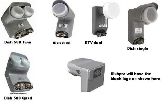

Dual LNB is a very confusing term. There are twin LNBs which are called dual too.
THAT IS 100% BULLSHIT AND BOGUS !!!
Twin LNB's are NEVER called DUAL LNB's...completely different animals...and even LOOK completely diffent....idiot Nalin!...
The DN mole Nalin is again posting BOGUS info, trying to get people to kill their boxes..
TWIN LNB is intended for 2 receivers , NOT 1...has internal switch , and gets 2 satellites
Dual LNB ...is intended ONLY for 1 satellite, and has NO internal switch..and requires an extrenal switch when used with another DUAL LNB...
TWIN LNB
VARIOUS LNB'S
DUAL LNB

I sort of agree with white hawk, all u need is replace that SINGLE LNB ( which only has 1 output) to a DUAL LNB (has 2 outputs for 2 receivers)..if ya just want to add another receiver from 1 to 2 receivers..
The circular DUAL LNB will get ya both DN and Bev encrypted channels and many FREE true "in the clear" channels..and is most commonly used..
The Linear Dual LNB is is only used for specific satellites that are less commonly used..
